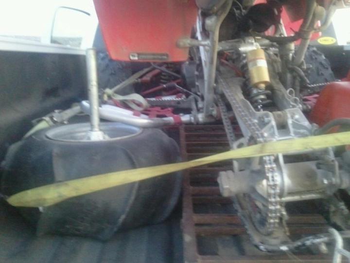

  1. Just thought i'd let everyone know, i bought a +2 banshee axle from forward powersports on ebay in may 2011. It seemed to work fairly well for the last 9 months of moderate dune riding until the friday before christmas when it snapped. I was heading back to the truck at the end of the day when i came around a corner hit two whoops and skid to a stop. I looked back and the whole left side of the axle snapped right at the lock nuts. I was able to ride the 5 miles back on three wheels, but boy was that a pain! That night i contacted forward powersports and they said" there is no warranty on that axle." I figured there wasn't but thought i would check. All in all i would not recommend this axle to anyone.
