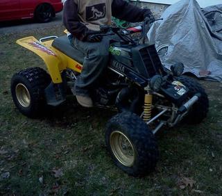

  6. lol i hear ya man i love the street bikes if i didnt go with the gsxr i was deff getting a cbr i love the 06's its nice to hear how different the bikes are i love the yoshi pipe i got! my buddy has an 05 r1 they look awesome! here are some pics of mine.. http://imageshack.us/g/714/20120323204414177.jpg/ my shee was running rich but i didnt have it lean out i honestly believe i have a bad crank seal but before i did the top end rebuild well what actually caused me to do a top end rebuild was i ran out of gas n called my mom to bring me some mixed gas she was acting stupid argued with me so i got towed to the gas sttion n she shows up which ust pissed me off to the max becasue she didnt hav any gas period lol so after i pumped i totally forgot to put oil in it than i relized how big of a fuck up that was so that could have casued a bad crank seal it stalled out n locked up when i stopped so i wasnt WOT or even any throttle at all when i got it home i used mystery oil to free it up and the exhaust spit a broken ring out than i rebuilt it im also guessing that my bottom end is just beat im doing a loakdown to be safe though make sure any gaskets arent leaking and to see if i find any cracks etc. ill post pics of the leakdown tomarrow after work.
