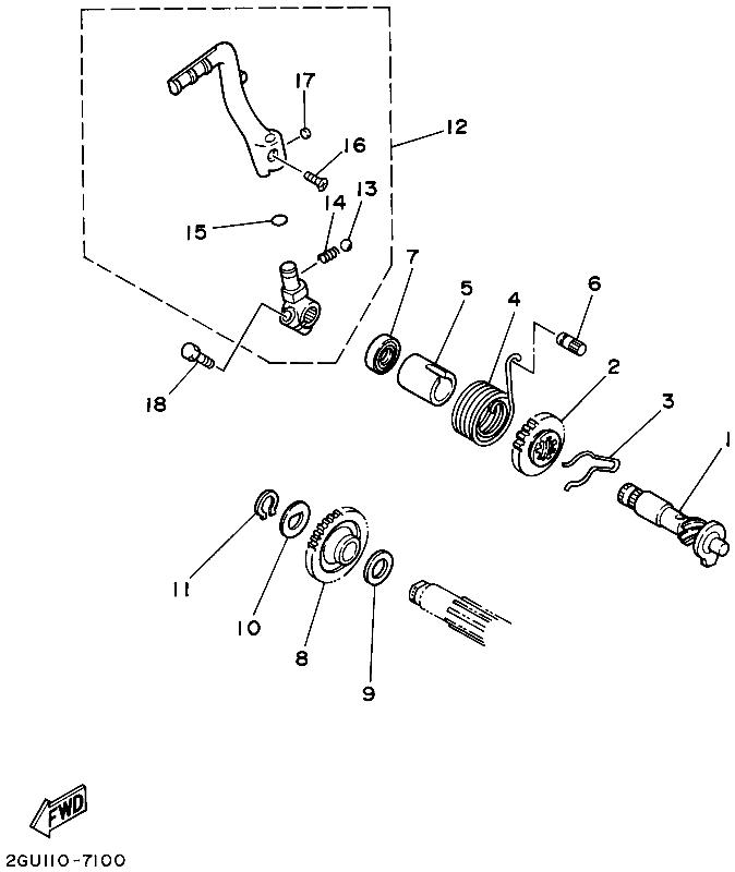

  5. Wanted to fill you guys in, I took out the kick starter assembly over the weekend, I had the end of the spring that goes through the kick starter shaft in the wrong hole. Once I moved it 180 degrees and put it back together it works great!! Thanks for your guys help!!

  7. OK, I will check that out when I get home. The main gear (#1 in the attached pic) has a small tab on it, does it need to go a certain direction, I am thinking this is where my problem is...
