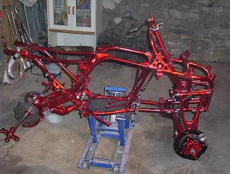

  9. i just got done repainting mine an i took it all down to bare metal, thats the only way your gonna get the best look. as far as lasting i can only tell you from my expierence that powder coat is stronger but it still comes off. check out my thread titled NEW PAINT, i have a blasting cabinet and a portable blaster that i did the frame with. i only spend 60 bucks in paint. im not done withn the bike yet so i havent ridin it yet. but for 60 bucks an some time i wouldnt mind doing it every year, gives me somthing to do in the fall and i get a chance to completely check every part of the bike for things that are broken or wore out.

  13. hey thanks man, but would you belive it the KRYLON touch!!!!!!! just did alot of prep work on it and the cleared the hell outta it to protect it from the dirt and rocks.

  18. its paint started with 3coats silver metallic , then 3 coats anodized red then 4 coats clear

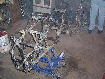

  19. well after a long few days its back to looking like a banshee again completely disasembled blasted and polished, polished parts are not all on it yet i just got it to a rolling chassie well almost still gotta clean up the tires an rims. but anyway heres what shee looks like sofar. let me k
  20. heres a pic getting ready to start blasting and repainting i will add new pics as they are taken
