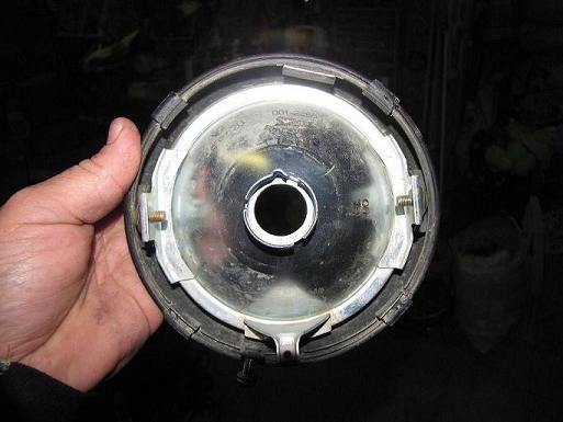

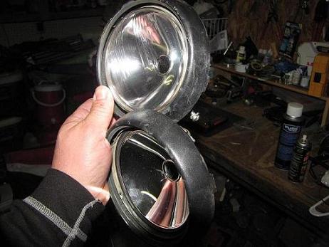

  16. K thanks, that will be the plan today after work. As far as I know it has a high output stator, at least thats what I was told but i have no idea what kind.
  17. Im still working on the jetting. I stuck 290s in it today and moved the needle to the middle position and it ran good but i checked the plugs and it looked lean and reved out fast. Tommorrow I am planning on 300s and back to the forth needle position. its 50s and was rainy today at 180 elevation. All I have read says I should be at 320 or 330 but it wont rev out at all. It has pods and pipe and upgraded stator and from what I was told mild porting. The temp and humidity changes are making this a bit more interesting.
  18. What does the needle that comes with the T5 kit have on it? I pulled the needles today and they look like the stock 5N7 with the clip in the 4th spot from the blunt end. If this is not the right one should I get the right ones or just use what I have?Thanks for any imput.
  19. both of them
  20. back of the broken one
  21. They are the stocks lights, one reflector housing is all plastic and the other one is metal and glass.
  22. I broke one of my head light lenses so I called up my local Yamaha shop and told him I needed one so he ordered it, he didnt ask what year i needed. So I went to pick it up today and it was plastic, the one I have is metal and glass. So what year do they change and are thay interchangeable? I have a 97 with the metal and glass lenses. I ordered new bulbs for 97 to 06, are they going to work. Thanks for any help you can give.
