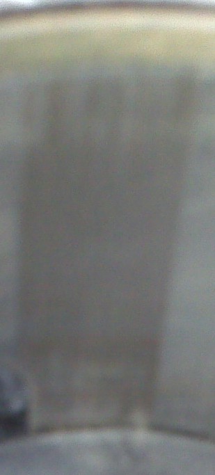

  16. My last dumb question/scenario... Could the air leak be the head gasket, from when the inner electrode from the plug fell out and made a divot in the piston from hitting the head?
  17. yea now i see that, thanks
  18. well after sitting here lookin at this cylinder and takin in your guys helpful comments i noticed on the outside of the left cylender on the right sideof it where the reeds are on the top and bottem corners there are 2 holes looks like it kinda blew from the inside out... not sure but could this be a air leak problem? Sorry dont know a whole lot about this.
  19. i think the scratches on the sidewall came from that divot, its almost right on the edge of the piston, i had to cut the picture down could only load 50kb, so there is a chance that the scartches on the sidewall didnt cause my bike to mess up?
  20. Ill start off by telling you what happened, I was out riding my 2000 stock banshee for a couple hours and everything was fine, then all of a sudden it was like i had to power band or power. So I shut the bike off to check my plugs, what I found was on the right cylinder spark plug that the center electrode fell out of the plug. so i thought no big deal it might of just went out through the exhaust. so I put a new plug in and when looking at exhaust of the bike the left exhaust there was verily any smoke coming out and the right side seemed to be fine. So I take the bike home, take the head off and find that on the left piston there was a small divot and right beside the divot on the cylinder wall was a 1/2" wide scar. its not deep enough to feel if your run you finger around in it when your not looking at it. Some of the things i was wondering is could this be honed out and if anything just get over sized rings. thoughts comments anything will help. thanks chuck
