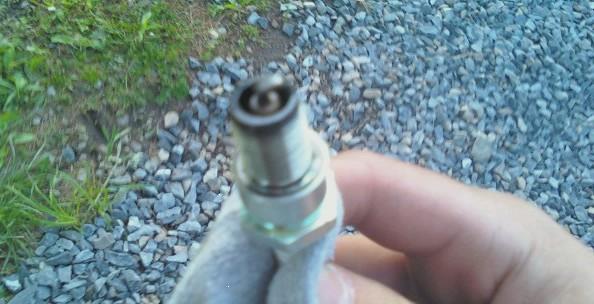

I dont think its a CDI problem it runs mint everywhere except for them i scream the shit out of it starts right up and doesnt do anything funny so i wouldnt THINK its a CDI?? I notice it breaking up after i go through some trail/slower riding. Ill replace plugs and they will look fine put new plugs in it runs great and then does it again next time i do slow riding or get a few hours on the plugs.

Elevation is less than 500 feet in in jersey. I am using standard b8es plugs non resistor type. Plugs look brand new when i take them out considering im only getting about a half hour to a set of plugs now. Bike runs great once warmed up then about after a half hour or 45 min of riding it runs like shit again.... when i had the t5 and it was running mint they were light light brown 310 mains.. My bike has always ran richer for some reason. Would a pingle help me out? also when i put the quad on flat ground and turn the fuel on carbs overflow but not real bad. idk possibly dying out on top end from lack of fuel??
