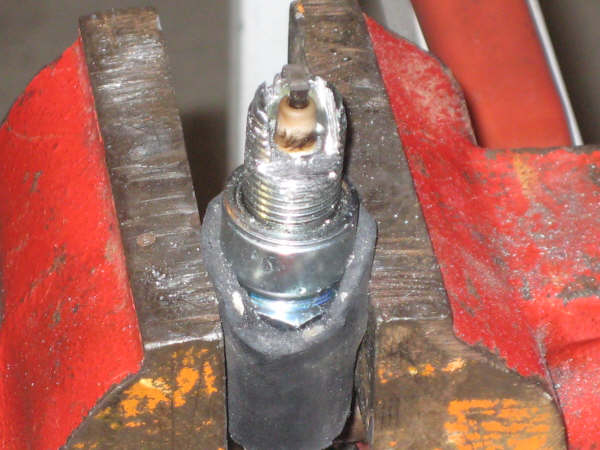

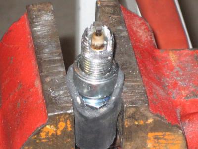

So i put the 162 main and put the CEL needle in third position, with fresh plugs. Did a 6th gear run pulled it hard. The only thing that scares me is the pipes were really hot, hotter than normal it seems. Still bogs a tiny bit and wants to die, when im not in the powerband (likes it starving for fuel when im at say 1/4 throttle then i go full on WOT) I Suppose i could work around that since its running alot better. Take a look at the photo let me know what you guys think is it good? Attached is the photo of the plug chop of the "New Plugs"
Plug chop shows black but they are old plugs. Does not back fire, kicks over on first kick without using choke. Ill try some 162's tomorrow and fresh plugs, i'll post what the findings are. Thanks for the replies.

Porting is gonna be done within the next few months one of the reason i went for bigger carbs I had 30mm PE carbs on there before but kept on leaking gas from the over flows rebuilt them adjusted them still leaked so i decided to get new carbs. As far as the picture on the spark plug does it look ok to rich / lean? will mess with the needles today ill let u know what i see when i adjust them. thanks for the info
