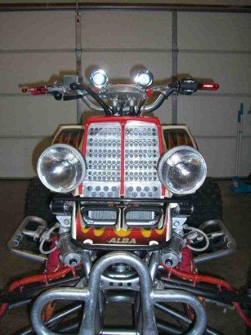

Got the bulbs in yesterday and rewired it lastnight using the tailight circuit for the low beams. Everything is working great. With my prior hook up the duners took a second to fire up so when you would switch from low too high it was dark for a second. Doesn't sound like a big deal but it is when your blasting down a gravel road doing 60 at midnight. That is a long second! Using the tail light curcuit, the lows never go off so you always have light. Throws a ton of light and I can steer the lows. Awesome!! -

I ride alot of wooded trails so the handle bar lights are great but I also ride alot of gravel at high speeds so I was trying to get all the lights working at the same time. 2 Reasons: as much light as possible and the ability to turn the lights down when I meet another vehicle. I am probably going to leave it as is. I had a bulb burn out and I was seeing if there was any room for improvement while I was messing with it. Not real hip on tearing into the wiring harness I just re-did about 6 months ago. I think I will leave it alone. -

I will definitely be pulling less amps. I already have the RS stator and regulator as well. I am going to run into an issue if I split the tailight lead and run three lights instead of one? Not sure if I am going to see a resistance issue. -

I read some of your other posts concerning electrical and DC conversions and I knew you were going to hit me with that one. I may leave it as is. I think I may be opening a can of worms and everything is fine as is. I was thinking I could use the tail light circuit because it is on for high and low beams. Thanks, Eric -

You are correct, I do want to run all 4 on high beam but I am actually cutting the wattage from from 200 down to 180 by changing the duner bulbs from 100 watts each down to 55 watts each. Current High Beam 100watts X 2 Total 200 watts Proposed High Beam 55 X 2 110 watts 35 X 2 70 watts Total 180 watts Am I missing something? What about splitting the tail light circuit? It is constant. I will check into the DC conversion. -

I have been running the current configuration for about 8-9 years with no problems and my current set up is pulling 100 watts per bulb on high. By dropping the Duners down to 55 watts each and hooking up TT's I would only be pulling 180 watts total instead of 200. I am actually dropping the wattage on high but using all 4 lights. That's my theory anyway??? I have had no problems with the factory switch I am just not sure how to make the TT's work on both low and high beam. -
Current Set Up Low Beams/ Trail Tech 35 watt bulbs High Beams/ RS Duner 100 watt Bulbs Max Low Beam Wattage-70 watts Max High Beam Wattage-200 watts Proposed Set Up Low Beams/ Trail Tech 35 watt bulbs High Beams/ RS Duner 55 watt Bulbs and Trail Tech 35 watt bulbs Max Low Beam Wattage-70 watts Max High Beam Wattage-180 watts My question is can I wire my factory switch to run the only the TT's on Low Beam and the TT's and the RS Duner's on High Beam? I would actually be running less total wattage on High than I am currently running with the 100 watt Duner bulbs.
