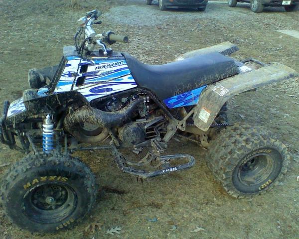

  3. http://pennstate.craigslist.org/mcy/1341884094.html For Sale: 2004 Limited edition Banshee. Low hours. Second owner with title. List of mods: Toomey t-5 exhaust with 2 into 1 filter set-up (stock box included) +4 advanced timing plate Boysean reeds TORS removed Works A-T steeler front shocks Renthal bars Maxxis rzr II's all the way around (have ITP holeshot spares) Nerfs Case saver other misc items as well 120lbs of compression in each cylinder. Only selling cause I want to get bikes for my kids. Asking 3000 neg. Bike is usually clean. Sorry only pics I have at the moment.
