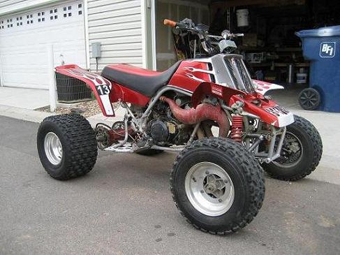

  6. alignment issue!!! before i swapped on the asr a arms the bike rode straight and true. air pressure in the tires are all the same. none of the breaks are dragging. I installed +2 +1 arms and i can't for the life of me get this f-en thing to ride in a straight line. as soon is a start out rolling the bars pull to the right and it pulls to the right. I bring it back to the garage check the tie rods. try different things and nothing changes it. i have it toed in about 1/8" to 1/4" and have the negative camber about 1/4" I'm going to try to go to 0 toe and camber and see if that helps anything. does anyone have any suggestions? Sledge hammer?

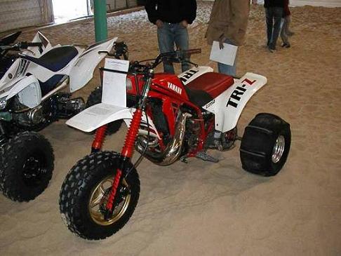

  7. Hey Chainsaw. I bought that red and white 86 off of you about 3 summers ago. I switched to a banshee a month ago. I had the hardest time selling the the tri-z. I couldnt find anyone to buy it so i practally had to give it away about 4 weeks ago to a guy out here in colorado. I had it in the show and shine a few months back here is a picture.
