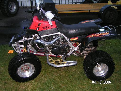

  13. I will trace the hose shortly, I found it behing the radiator and asumed it was the one from the head. It is a loose vent hose that is placed up behing the radiator, what else do you think it could be?
  14. Stock
  15. I beleive it is the only 1/4 tube coming from the top of the head. He has no loss of power at all but during his races it vents oil. I do beleive the o-rings have gone out in the head.
  16. Once again I need your guys help with my sons banshee. He is in a points championship battle this year with his banshee and just recently we have found oil coming fromt he vent tube on top of the head. The last 2 races this has happened, he does not however have any loss of power. I really need your help on this one. Let me know what you think. Thanks, Rich and Bryan
