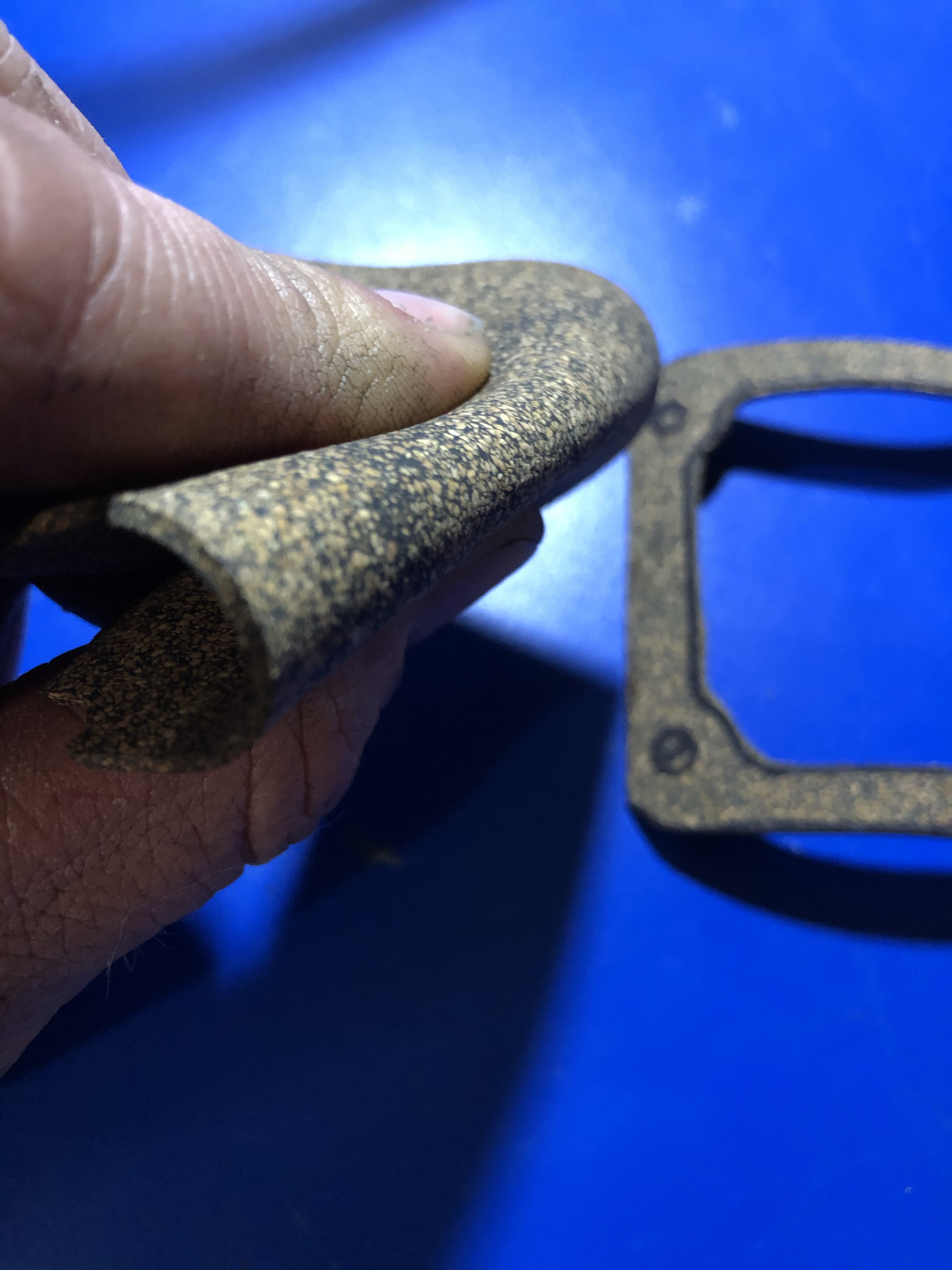

I made some intake gaskets to seal between the rubber boot and reeds. Used Fel-Pro 1/16” rubberized cork I think. I’m not sure what exactly the material is. I found it in my tool box It’s Fel-pro for sure. Anyone help me out. It passed the leak down at 8psi. Held for 3 hours. But I’m worried about the what gas might do. Should I order some different material to make new ones. Everything takes forever to order. Was 2 weeks waiting to get all my seals for the bottom end. I know I can get some gasket material down at the auto parts store in the AM. Here’s a pic of the material. Sent from my iPhone using Tapatalk
Update. Had to yamaBond the new reed gaskets and I made two more to go between the reeds and OEM Intake. Might be time to upgrade. It’s been holding 8psi for around 3 hours now. Should be good. Sent from my iPhone using Tapatalk
