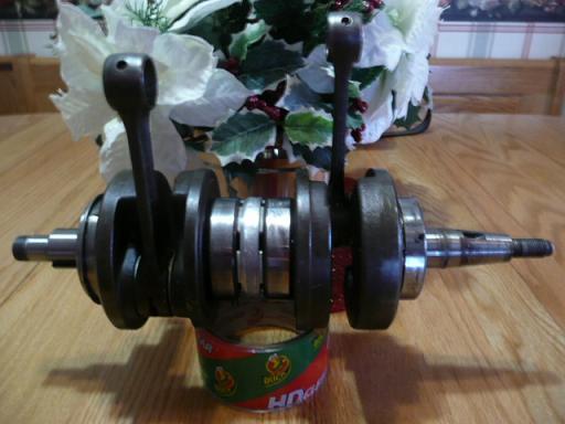

  3. C.K. 121 I can post a pic of the hot rod stamp opposite the numbers. tks for the question
  4. Hot Rod Crank used ( but, not much) stock stroke shipped from Michigan $130.00

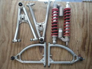

  8. I have a set of '05 yfz modified a arms with '05 trx (1" longer 16.5") gas res shocks for $225. shipped a set of stock front hubs $40. shipped a set of '05 yfz unused front shocks $80. shipped like new Clymers banshee manual $20. shipped
