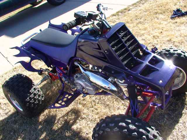

Pics are up! My picture post, click here. Took it out yeaterday but forgot my jets and my extra plugs. It was way rich and fouled the plugs in about 20 min. Brought her home, changed the jets and plugs and did a quick run up my street and WHOOOOAA YAH BABY, SHEE RUNS!!! -
Well after six months and expecially the last 2 weeks I finally fired it the Shee up last night. Sounded like a 1000 hamsterpower running in a cage. Actually went to start on first kick, then took about 10 more and then BOOM started right up. Starts every kick now. She sounds healthy, really healthy! I promise I will get some pictures tonight. One question though. Do most people just run individual lines from the breather ports? I mean the hose that comes out of the crankcase, the nipple on the back of the cases by the engine mount, and the overflow from by the radiator cap. from what I can see looking at stock machines, these three lines are conected together. Is this correct?
