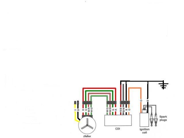

could it possibly be the way my coil is grounded. I know that in order for a coil to fire it must have power to it to build the magnetic field, then there must be a break in the circuit for the field to collapse and allow the current to shoot down the spark plug wire. As of now the negative wire is grounded directly to the motor, so what I am wondering is where does the circuit get its break in order to fire the coil. Is it on the negative side, or is it controlled through the positive side. If it is on the negative side, do I have to run the black coil wire to the cdi box and not common ground. As of now they both run directly to engine ground. -

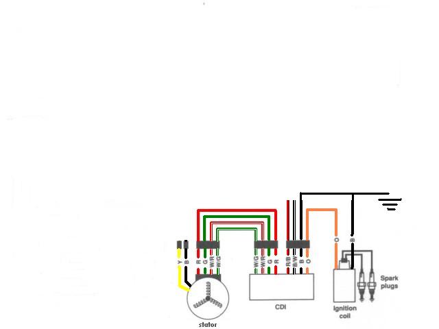

I changed the harness to ground red/black my pic shows the change, still no spark when holding the plug on the head and kicking. How I tested for power at the coil was hooking my meter up to the orange wire and ground and kicking the bike, the meter peaks like it is trying to read the voltage but it isnt long enough to give a readout, but it is peaking and showing current with the little bar graph display on the meter. -

I have tested the coil and it passes, it is not discharging like it should, my ide of the coil operation is the coil charges, the pickup coil sends a signal to the cdi and the cdi has the ignition coil discharge. It seems to be getting power but not releasing it to the plugs. I have no spark through the wires even with the caps off the wires. It has no off and on switches, they have all been bypassed. It has no spark at all, the coil is wired right, I have two bikes to make sure things are right. One thing I think is the red/black wire from the cdi needs to be grounded, I tried and it made no difference. Thanks for any help!!! -

No, only whats in that pic is what is left -
This is a mess, I bought a bike, it turned out to be a peiced together joke, so I parted it out to start over. Spent 15 hours yesterday and got my all new bike together and it has no spark. I have swapped the stator with a brand new one swapped the cdi swapped the coil I have power to the coil, my meter spikes on the orange wire when I kick the bike over I have tested the coil, pickup coil and stator. I have pulled the harness, checked every wire I took the harness and cut out everything but ignition, grounded the cdi and the coil, and still no spark. I dont know what to be looking for, I assume if the coil has power, it is not discharging, so pickup coil or cdi. I have tried two pickup coils, swapped the cdi's and verified the pickup coil gap. I have a pic of what I did to my harness, my grounds are right to the head studs. I even tested ground continuity. I may have the kill switch wires messed up but I dont think so. Basically I figure the red/black black/white wires coming off the cdi need to be open to run, when they complete the circuit it kills. but I may be wrong. I have seen posts of the flywheel being bad, I just had it machined, this bike ran 3 weeks ago. I am worried because I pinched a dome seal and got coolant in the bottom end, I want to get this thing running asap to make sure it is all out, any advice would be appreciated!!!!!!!!
