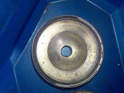

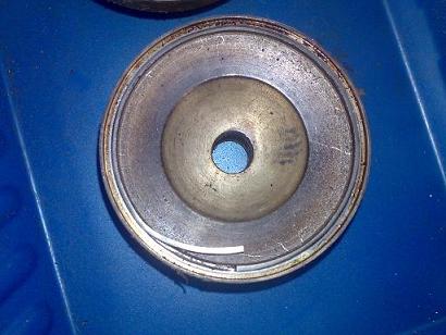

here are some pictures i took for both doomes i have installed everything back and my engine was perfect than ever compression was 165 on both cylinders. i just changed all the gaskets and piston rings. -

thanx all 4 replying. Both of my pistons are perfect are like new. If i switch between them nobody would tell which was producing the 207 psi. I think the problem i am facing are the dooms. There is a crack on my right doom. I had pro design dooms but now i have vitos. I got it milled for the 4 mil. I will try it 2day and we will see. -

i have removed the cool head. Both piston were perfect but way rich. They were blacked out and oily. The right cylinder doom had a very small chip at the inside on the tip. Could this increase my compression or rather decrease it. I was running my shee with 91 octane fuel fo r a year. I bit that with a compression 207 my piston would have cracks. Am thinking of buying new doomes but i am afraid that it may not be the problem -
