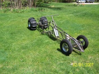

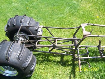

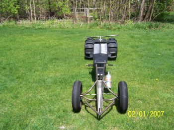

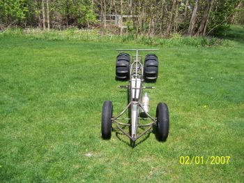

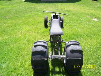

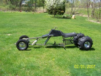

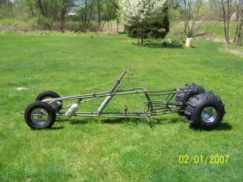

twister688 Posted May 4, 2008 Report Posted May 4, 2008 Here are some pics of my new ridged drag frame by tyson racing +36 out the front and +16 out the rear or 105 inch wheelbase. Quote

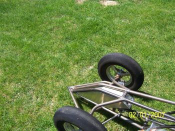

twister688 Posted May 4, 2008 Author Report Posted May 4, 2008 Here are some pics of my new ridged drag frame by tyson racing +36 out the front and +16 out the rear or 105 inch wheelbase. Quote
alcoholbanshee Posted May 4, 2008 Report Posted May 4, 2008 Damn Sean....that looks awesome!!!!!!!!!!!!! Gonna be ready for Bobs this weekend??? I hope to have the mini twister done.............................................................maybe??? Quote
twister688 Posted May 4, 2008 Author Report Posted May 4, 2008 Damn Sean....that looks awesome!!!!!!!!!!!!! Gonna be ready for Bobs this weekend??? I hope to have the mini twister done.............................................................maybe??? no i'm still waiting on the motor should be soon though. What size twister did you build? Quote
alcoholbanshee Posted May 4, 2008 Report Posted May 4, 2008 10mil 75 bore.......565cc's.....I got the cases from Evan.....so I assume you cut them......nice work!!!!!!! The engine is all together....checked squish today and it was .032. That is a little tight IMO. Gonna call Lew tomorrow and see what he says. What do you think??? Quote
twister688 Posted May 4, 2008 Author Report Posted May 4, 2008 10mil 75 bore.......565cc's.....I got the cases from Evan.....so I assume you cut them......nice work!!!!!!! The engine is all together....checked squish today and it was .032. That is a little tight IMO. Gonna call Lew tomorrow and see what he says. What do you think??? .045 - .050 squish and 180-190 lbs of compresion Quote
dajogejr Posted May 5, 2008 Report Posted May 5, 2008 God Damn..McFly... That frame is sweet....you weren't kidding!!! Can't wait to see it go down the track!! Quote
