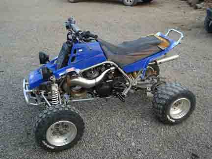

Thanks for all of your help guys. I messed with it a little this morning and I think I have it figured out. The throttle seemed like it was adjusted a little too tight so I loosened that up and it's running good for now. It may be a little sticky too but, I think the major problem was it flooding when I was trying to start it. Starts first kick and it will start and idle when it's warm. So far so good. I plan on going through everything I just wanted to make sure it would run and there weren't any major issues before I start dumping money into it but, for a $200 machine I can afford to spend a little. Here is a pic if it will upload.
Hell yea looks good...i see billet pipe clamps, kenda klaws different front bumper and different head too, sweet.
