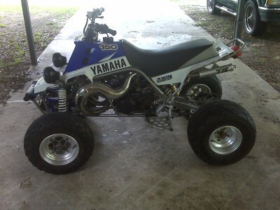

My Bike Won't Idle and Oil is Milky! I took it to a mechanic and he supposedly fixed it. When I got it back to the house it took 30 Mins to start. After I got it to Start I took it for a ride and another bike rode up on me and he hit it so I hit it. When I got home I was going to change the oil and when i drained the oil it was milky. So Bike won't IDLE and the Oil is MILKY!?!?!? HELP????
dont know bout the idle but sounds like your getting coolant in your oil. theres a seal for your impeler that goes bad no to hard of a fix. do ya have a clymers?
