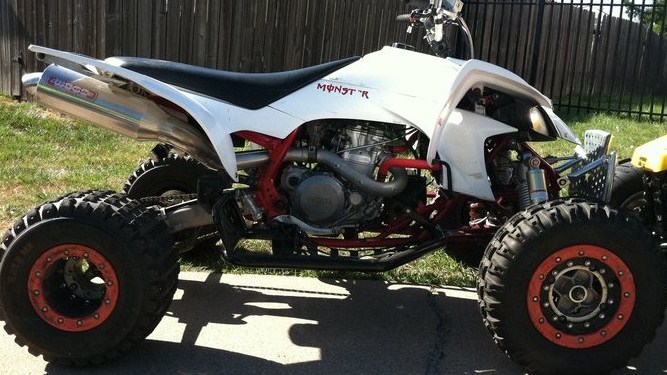

lastnline75 Posted June 22, 2011 Report Posted June 22, 2011 getting closer to finishing the build and i need some help picking new wheels. i am looking at the hyper tech 3's. anybody running these and what are your opinions? also what offset do you run for the front with +2 a arms? thanks for any help! Quote
SAVAGE420 Posted June 22, 2011 Report Posted June 22, 2011 4:1 for front offset is what you want. Don't make a mistake and get something else. Go 3:2 out back. Quote
DallasGDub Posted June 22, 2011 Report Posted June 22, 2011 If you plan on swapping tires in and out, get dual beadlocks. You can swap out the tires with a ratchet in a matter of minutes. The single beadlocks still require you to break the inside bead, and tire tools to slip the tire over the inside of the rim. Quote
KickStartMyHeart Posted June 22, 2011 Report Posted June 22, 2011 Unless you are jumping huge jumps or MX racing you do not need them. They are really heavy and overkill. I have a set of the wifey's yfz and the only reason I have em is because I bought the entire set including tires for $300. THey are single beadlock Tech3's. And NO they arent for sale Quote
Infamous039 Posted June 22, 2011 Report Posted June 22, 2011 Excellent rims, you can run low tire pressure b/c the beads are locked on. I would say buy them if you can afford there price tag. Quote
