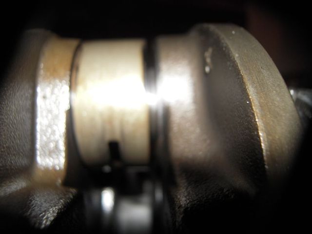

AdrenalineJunky Posted April 28, 2010 Report Posted April 28, 2010 Is this too much side to side play for the rod? What causes this and where do I go from here? Quote
dajogejr Posted April 28, 2010 Report Posted April 28, 2010 Side play clearance spec is .0098 to .0295 in inches. That looks like it's starting to separate... Quote
toytech Posted April 28, 2010 Report Posted April 28, 2010 Is this too much side to side play for the rod? What causes this and where do I go from here? the bank Quote
bansheesandrider Posted April 28, 2010 Report Posted April 28, 2010 It looks like too much side play to me. You have 2 choices-rebuild what you have or purchase a new crank. it will cost you about $350 to have it rebuilt with new rod kits and new main bearings and having it trued and welded. A new stock stroke, stock length rod crank will cost you about the same, but it will not be welded. I have Twister Crankshafts do all my crank work and boring also. Quote
blowit Posted April 28, 2010 Report Posted April 28, 2010 Side play clearance spec is .0098 to .0295 in inches. That looks like it's starting to separate... Agreed. Looks like separation. If the crank is good and you want to keep it, just send it in to be trued/welded. They should press it back together, true it, then weld it up. Problem solved. Rebuilding is not a certainty unless it is inspected and proved bad. True/weld is usually around 100 bucks. Mull Engineering Quote
AdrenalineJunky Posted April 28, 2010 Author Report Posted April 28, 2010 That's what I was afraid of. Separating? What are the Banshee cranks like a 2 piece design that everything is pressed together? I planned on doing new bearings and seals anyways. So this was a timebomb and good thing I took it apart a? Quote
toytech Posted April 28, 2010 Report Posted April 28, 2010 Is this too much side to side play for the rod? What causes this and where do I go from here? vito's performance products has a 4mil stroker crank that is trued and welded with the plate and gaskets for 500 bucks, thats what I just bought Quote
dajogejr Posted April 28, 2010 Report Posted April 28, 2010 vito's performance products has a 4mil stroker crank that is trued and welded with the plate and gaskets for 500 bucks, thats what I just bought You'll also need the cylinders ported to match the stroke for the right performance. Quote
AKheathen Posted April 28, 2010 Report Posted April 28, 2010 if you are gonna have it built, make sure the flywheel seat is good, or get it resurfaced, too.....usually a loose/improperly seated, or bent flywheel leads to crank separation, from what i've seen. Quote
AdrenalineJunky Posted April 28, 2010 Author Report Posted April 28, 2010 Hmmmmm, might just have it rebuilt then. When you buy a stroker crank what all needs to be changed? If I have to do much changing I just stick w/ stock. Quote
SLORYDER Posted April 28, 2010 Report Posted April 28, 2010 Hmmmmm, might just have it rebuilt then. When you buy a stroker crank what all needs to be changed? If I have to do much changing I just stick w/ stock. Yeah my crank did the exact same thing. I've heard of others doing the same-I wonder what could be causing this? I sent mine to HJR I believe it was $75 to fix. Might as well send your jugs toget ported while you're at it. Quote
bansheesandrider Posted April 29, 2010 Report Posted April 29, 2010 Banshee cranks are actually made from 5 seperate pieces- the center pin, 2 inner wheels that have the rod pins on them and 2 outer wheels that have the outer bearings and the journals to mount the flywheel and primary drive gears on. It is all pressed together and held in place by friction/interference fit.When you start increasing the power of you Banshee, it generates forces that overcome the press fit and the crank starts spreading. Yamaha says that there is only a problem with "modified" bikes and therefore never did anything to rectify it. I lost my crank when the bike had nothing more done to it than pipes and paddles, Yamaha considers paddles a modification. I have never lapped or seated a flywheel and I have never had one come loose. I install it and torque it to factory spec with blue Loctite and it has never come loose.If the crank runout is in spec, the flywheel and crank are not damaged from being run loose, and the flywheel is properly tightened, there should be no problems. If a crank has started spreading, there is no way to see if the thrust washers or crank pins have been damaged without taking it apart for inspection. If it is apart to inspect, you might as well put new rod and main bearing on it. It is far cheaper to rebuild it while it is apart the first time, than it is to repair all the damage after it lets go- it cost me over $700 to fix mine when my crank let go. And that was using a set of takeout pistons and not boring it, I had to be cheap because I was unemployed at the time, so I made sure that everything in the bottom end was in good shape so I could just pull the jugs and do a topend to get every thing in good shape once I went back to work. Quote
