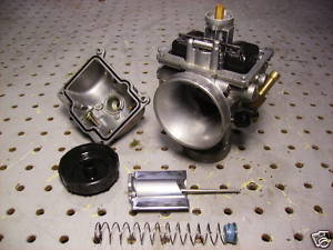

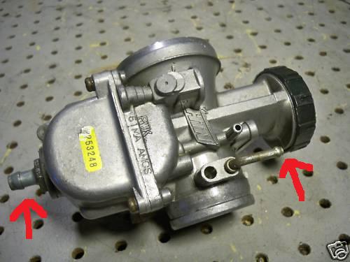

Alex29573 Posted February 23, 2010 Report Posted February 23, 2010 can anyone please tell me if these will work and what do i do with the nipple coming out of the bottom of the float bowl? also, what about the other nipple i put an arrow on? and where i put in the fuel hose from the gas tank, does it matter that these carbs have the nipple facing down? Quote

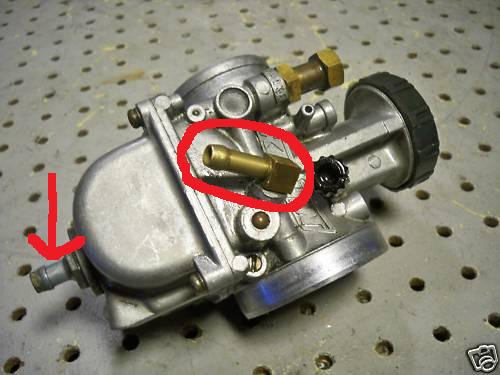

Alex29573 Posted February 23, 2010 Author Report Posted February 23, 2010 second pic showing the fuel inlet that faces downwards Quote

sheefreak Posted February 23, 2010 Report Posted February 23, 2010 They are prolly a pumper carb w/the inlets turned down. I am not sure what the nipples are w/o having the carbs in front of me. Quote

Blewbyu Posted February 23, 2010 Report Posted February 23, 2010 Those are defenetely pumper carbs, you would have to buy a pump and put a pulse line in your cylinder, but they will work on your bike. just cap off that other vent on the side and buy the nuts that come on the 39pwk gravity fed bowls and replace those with the ones on your bowls. Obviously you will have to jet accordingly... Quote

J-Madd Posted February 23, 2010 Report Posted February 23, 2010 thanks man, i think i will just look for a regular set of gravity fed PWKs!! how can i tell if they are pumper or gravity fed carbs? By re-reading Blewbyu's post j/k. THe fuel inlets are pointed down on the pumpers. You'll also need to put some chokes in those. Quote
sheefreak Posted February 23, 2010 Report Posted February 23, 2010 There are also pumper carbs that have the inlets facing up. You can tell the difference by the size of the fuel inlet. I am not sure what the sizes are but the inlets on pumper carbs are smaller than gravity fed. Quote
superfastyfz450driver Posted February 24, 2010 Report Posted February 24, 2010 snowmobile carbs use a very small neede and seat set up like on a mikuni tmx set up for a sped will use a size 1.5 needle and seat but for gravity feed your going to need a size 3.5 in my oppinion if the inlet port for the fuel line was angled down or up for gravity feed wouldnt make a difference it was probably done like that to route the fuel lines on the sled properly, th nipple on the bottom of the float bowls is for whats called a water trap on most sleds they use a chunk of 3/8ths clear hose roughly 2-3 inchs long with a plug in the end , what this does is since water is heavier then fuel it will get trapped in there rather then lay in the bowl, periodically you should drain them to make sure everything is ok Quote
