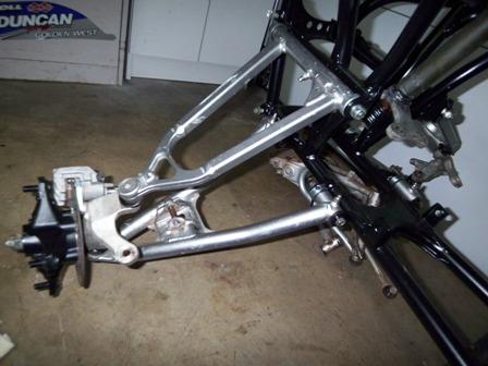

Did a yfx conversion. I have stock tie rods and yfz tie rods. Both too short. Looking for grizzly tie rods but want to know of they will bolt on snug with zero issues or modifications needed. Or should I go a different route? looking for lowest cost but also don't want crap thats weak. Anyone got any info? or tierods for sale that will fit?
I used the grizzly 700 tie rods on my conversion but you need to use the ball joints with them as they are different sized threads. If you decide to go this route ,use the kit from Allballs. The rods and joints are beefier than the stock ones. the rods are exactly 2'' larger than stock.
to confirm. I need to use grizzly tie rods and grizzly ends as well? The rod itself is 2" longer then the stock banshee one?
