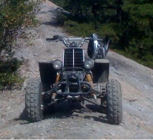

drlguy Posted November 24, 2009 Report Posted November 24, 2009 I am getting ready to do some motor work on my original 02 Banshee topend and am wondering what will give me the best bang for the buck without seriously limiting what I can do to the motor in the future. We mainly ride trails, silts, and do some hill climbing. The bike runs great but I know I have a good amount of hours on the original pistons and rings. With 20cc domes I am getting a very even compression measurement of 145psi. I have been doing some research on porting work and there are a few porting options out there that seem to suit my riding. Trinity offers a mx port that will allow me to continue to use the current setup minus the carb needles and jets. They told me I will get 10 hp out of a port job and the work should come in under $875. FAST offers a woods port for $250 but I will need to change to a different carb setup...Then I start to look at stroker cranks and that changes the whole game. If I go ahead with a mx port and then later decide to stroke is my porting going to be correct. I am also concerned with my stock cluch...anyone had luck throwing that much power into one? The bike runs strong now and I think it is producing about 55hp. Any suggestions/feedback is greatly appreciated. Current motor mods include: Toomey T5 pipe kit NOS coolhead with 20cc Domes V force Reeds +4 Timing, Aluminum Impeller Torrs Elimination. All of my buddies are riding 450s and 700s and they are slowly starting to catch up.... Quote
