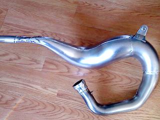

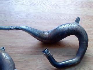

decon Posted July 25, 2009 Report Share Posted July 25, 2009 (edited) I bought these shearers real cheap but they have rust. I was wondering how could i get it off easy? i've been using WD40 and fine steel wool, It gets it off little by little but I have a lot of it. here are some pictures. any suggestions without messing up the chrome? Edited July 25, 2009 by dEcon Quote Link to comment Share on other sites More sharing options...
Darthwall Posted July 25, 2009 Report Share Posted July 25, 2009 I normally use chrome polish but there was a thread on here awhile ago saying to use wood bleach I think? you dilute it down and soak the pipe in it for a day or so and the rust comes off no prob I think it was some nasty stuff to deal with but works good hopefully he will chime in Quote Link to comment Share on other sites More sharing options...
dajogejr Posted July 25, 2009 Report Share Posted July 25, 2009 Plastic scraper of some kind, SOAK them in PB Blaster or WD 40. Soak rags in that stuff and wrap the pipes in them. I used Neverdull and a ton of time and elbow grease to finish the pipes I had up...they weren't as bad as yours, though to be honest. Quote Link to comment Share on other sites More sharing options...
wesw Posted July 25, 2009 Report Share Posted July 25, 2009 i would fire up a buffing wheel and go to town on those wow you better got them almost free for the conditions they are in. Quote Link to comment Share on other sites More sharing options...
TwistedSheeRida Posted July 25, 2009 Report Share Posted July 25, 2009 easiest thing to do. go to walmart get some of that clr calcium lime rust remover spray on let sit and rub off with a scotch brite pad. brillo pad. Quote Link to comment Share on other sites More sharing options...
docjcwatson Posted July 25, 2009 Report Share Posted July 25, 2009 easiest thing to do. go to walmart get some of that clr calcium lime rust remover spray on let sit and rub off with a scotch brite pad. brillo pad. x2! Quote Link to comment Share on other sites More sharing options...
decon Posted July 27, 2009 Author Report Share Posted July 27, 2009 used the wood bleach technique and then used some turtle wax chrome polish they look better Quote Link to comment Share on other sites More sharing options...
