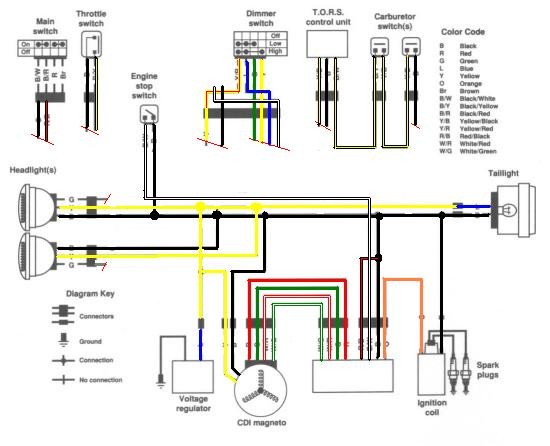

JTP Posted April 23, 2009 Author Report Posted April 23, 2009 When i rewired the bike, i did it just like the diagram thats on this form. http://www.dfn.com/benkaren/elecfaq.html It did the same thing befor I rewired the bike also Quote

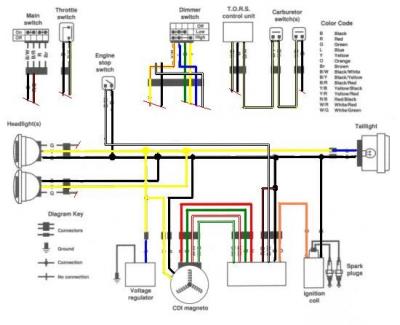

JTP Posted April 24, 2009 Author Report Posted April 24, 2009 this is what i used to wire the bike. The TORS controls the Rev at 3k right? The TORS box is not hooked up and not even on the bike. Correct me if im wrong, I just want to find the problem with this thing. Thanks for all the help Quote
