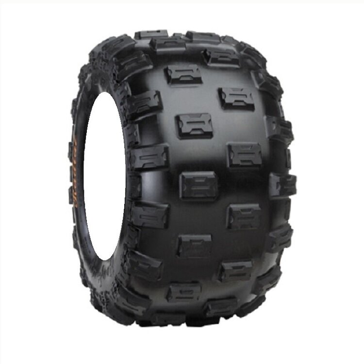

  3. Seen these on ATVtires.com there pretty interesting but I’ve never heard anyone mention them. They seem like they would “Hook Up” haha has anyone had any experience with these👍🏼
