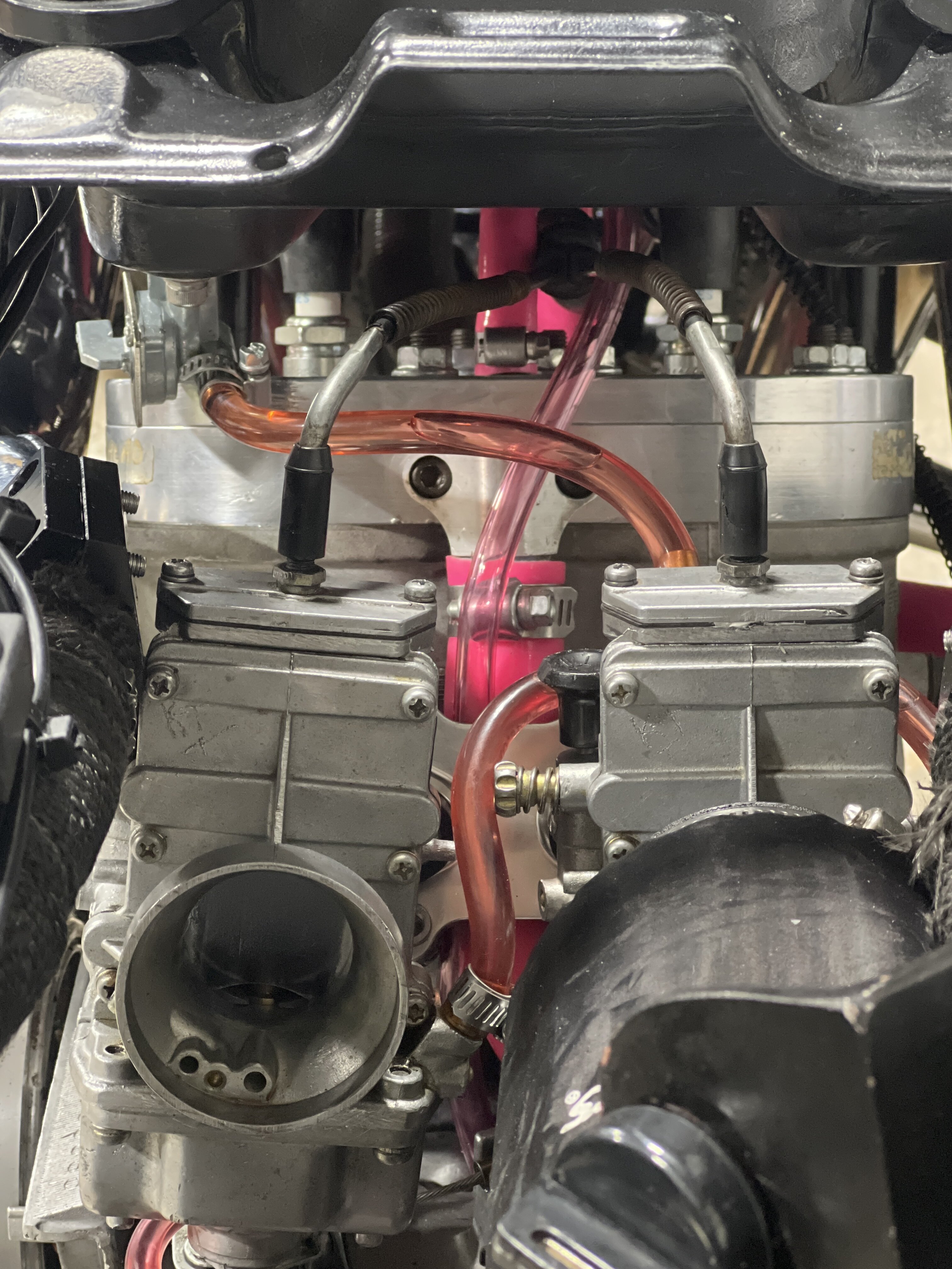

  1. I have not and did not think of that but even with the screw backed out a decent amount it still seems to hit the left carb but I will try adding a washer and seeing if that makes it different thanks for your input!
  2. Has anyone on here had any issues with their t5 or similar pipes hitting their carb? My right side sits straight but my left forces the carb at an angle. Thanks in advance!
