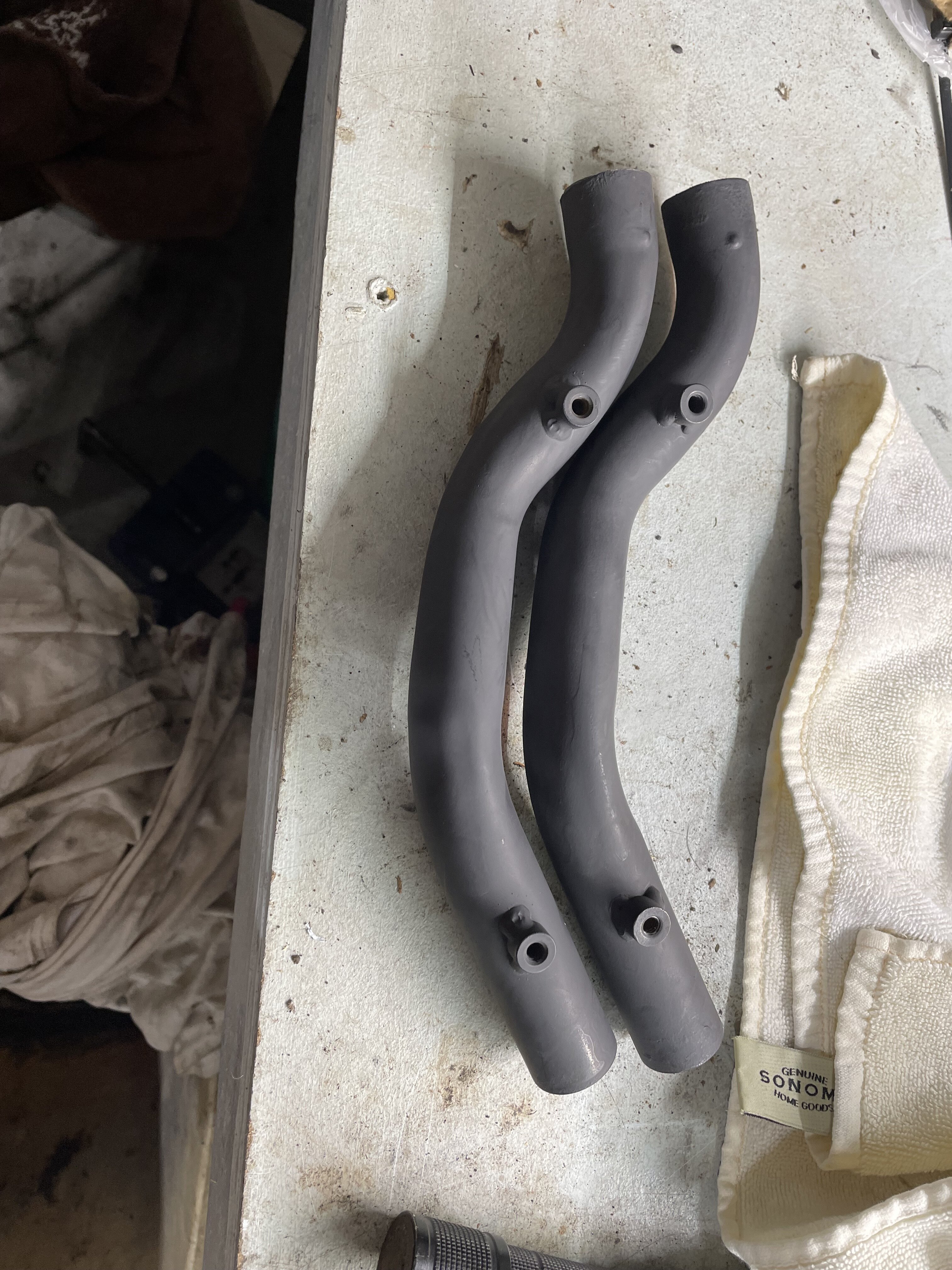

  1. are the stock mid pipes identical shape on both sides with just different mounting points for the heat shields? I ask because I believe I have two right sided mid pipes and my plan was to use what I have but just reweld the mounting points for shields on the opposite side for the pipe on left side of bike. I don’t have silencers yet so I can’t tell if everything lines up. Thanks
