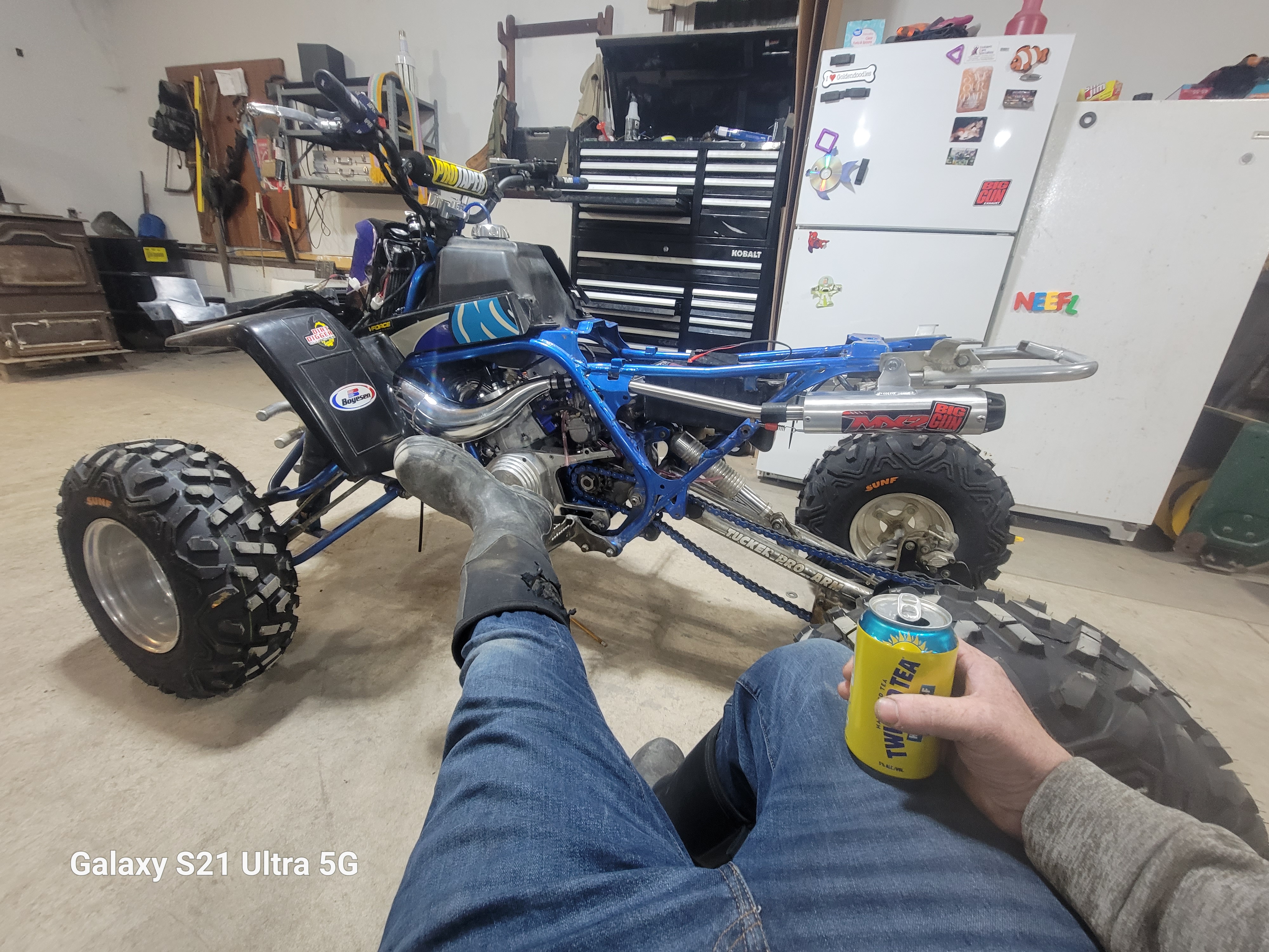

  1. I think you're right i jumped the kill wire and now i have spark all the time and key will only work lights. Which im fine with... thanks guys.
  2. And it work prior to my dc conversion.
  3. I got my dc harness from south texas banshee. Lights are wired in appropriately. The key is just a run of the mill ebay buy. I might try a key delete I got my dc harness from south texas banshee. Lights are wired in appropriately. The key is just a run of the mill ebay buy. I might try a key delete. Its just puzzling.
  4. My 01 banshee has a dc conversion kit. When the key is on i have lights but no spark. When the key is off i can start it but lights wont work. Do i need to rewire my key?
  5. My 01 banshee has a dc conversion kit. When the key is on i have lights but no spark. When the key is off i can start it but lights wont work. Do i need to rewire my key?
