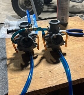

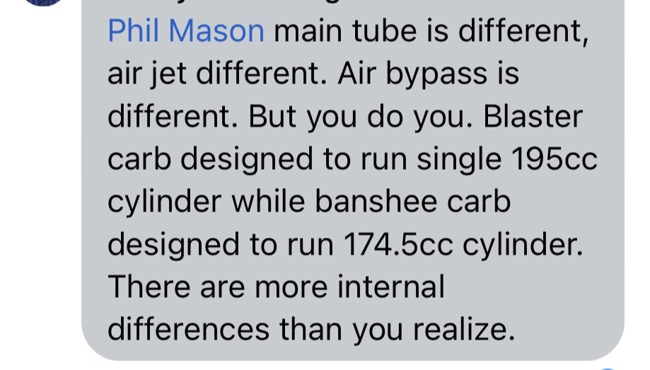

  5. Hey all, I discovered I have a blaster carb (with choke) paired up with my banshee carb. I just had them cleaned and rebuilt with Vito’s rebuild kits. I’d hate to have to buy another OEM banshee one, so would I be okay? They seem similar.
  6. Hey all, I discovered I have a blaster carb (with choke) paired up with my banshee carb. I just had them cleaned and rebuilt with Vito’s rebuild kits. I’d hate to have to buy another OEM banshee one, so would I be okay? They seem similar. This post on Facebook has me curious. Thanks!
