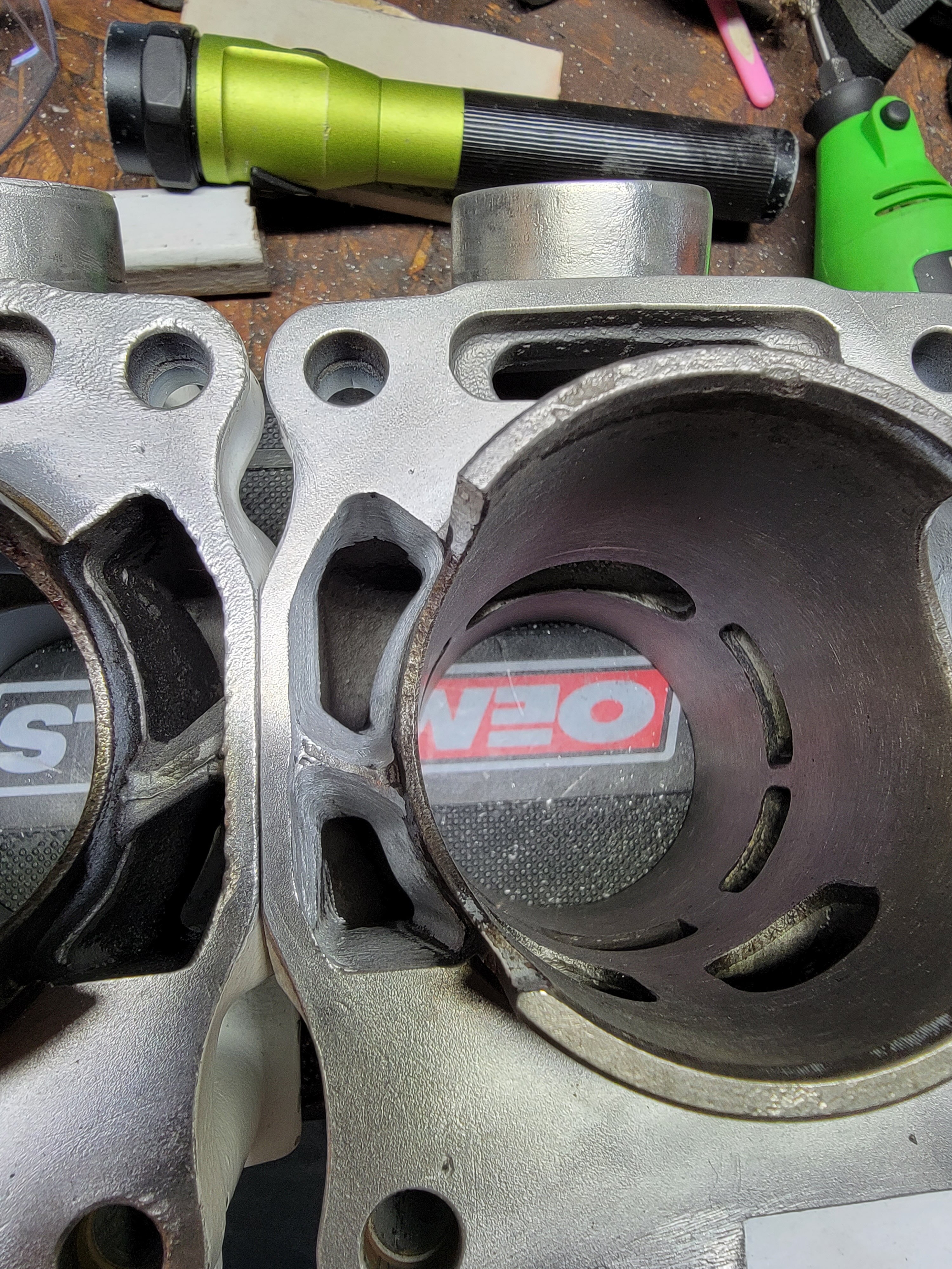

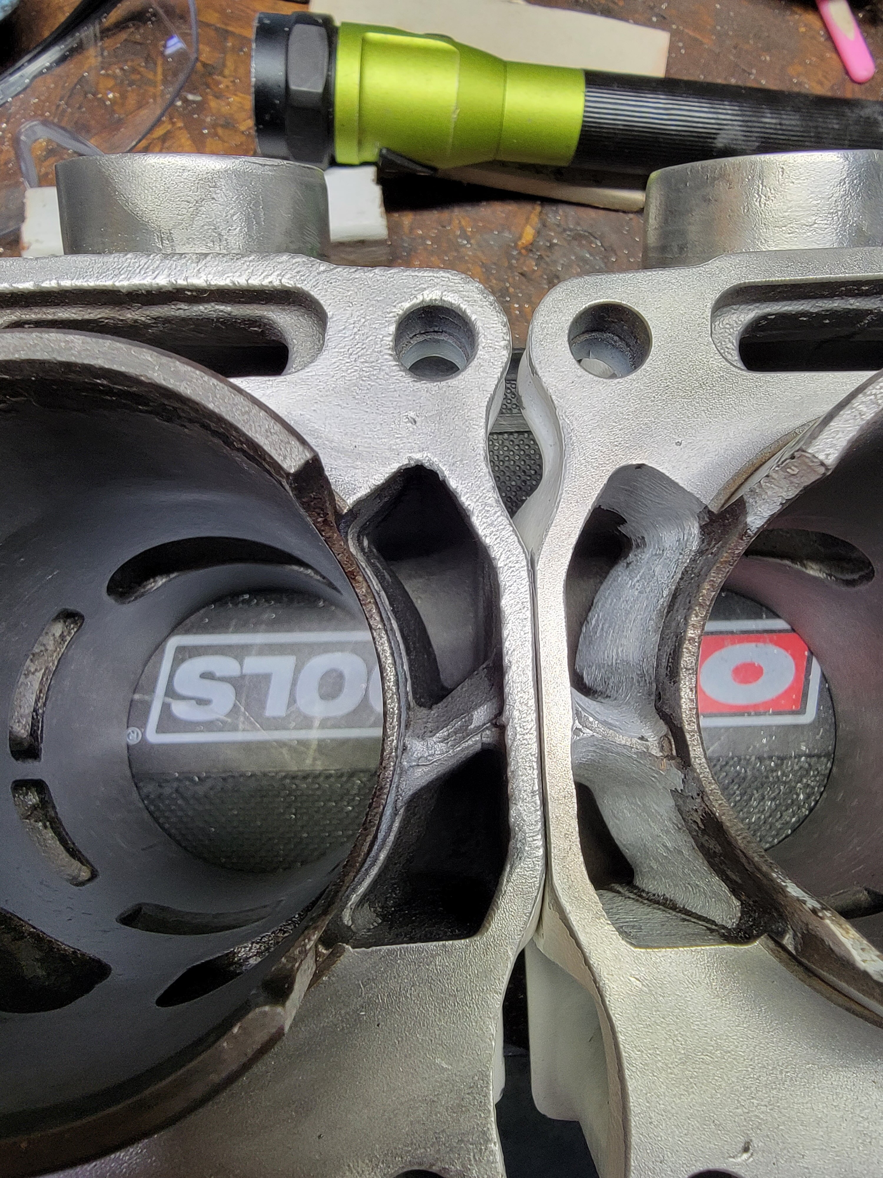

  5. Since it seems to be a big fucking secret and the so called pros don't answer questions maybe someone here can help me out.im learning to port my own cylinders.by these pics can anyone tell me if I'm doing this correctly? Thank you Ps these are before and after pics of my transfer ports
