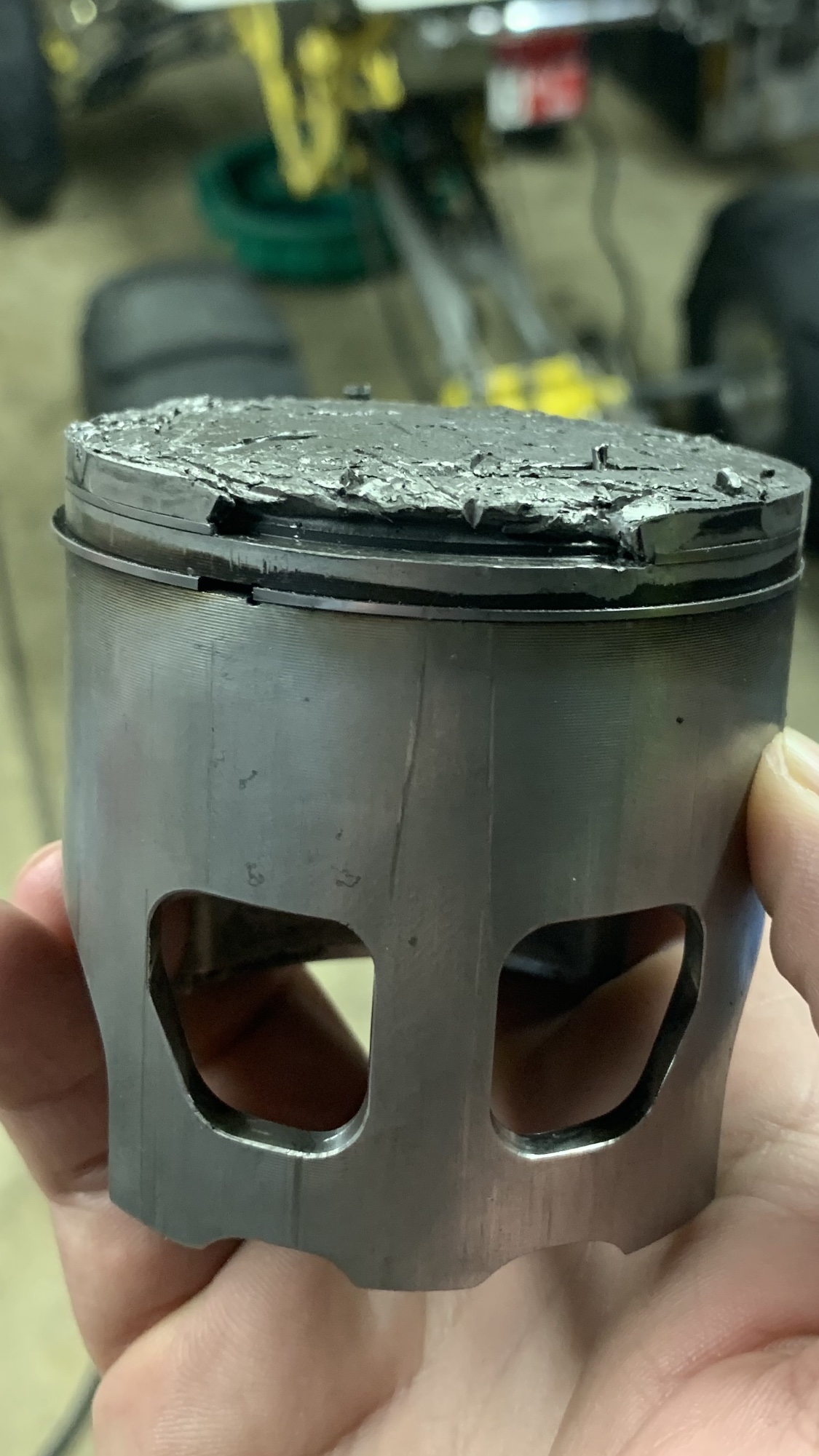

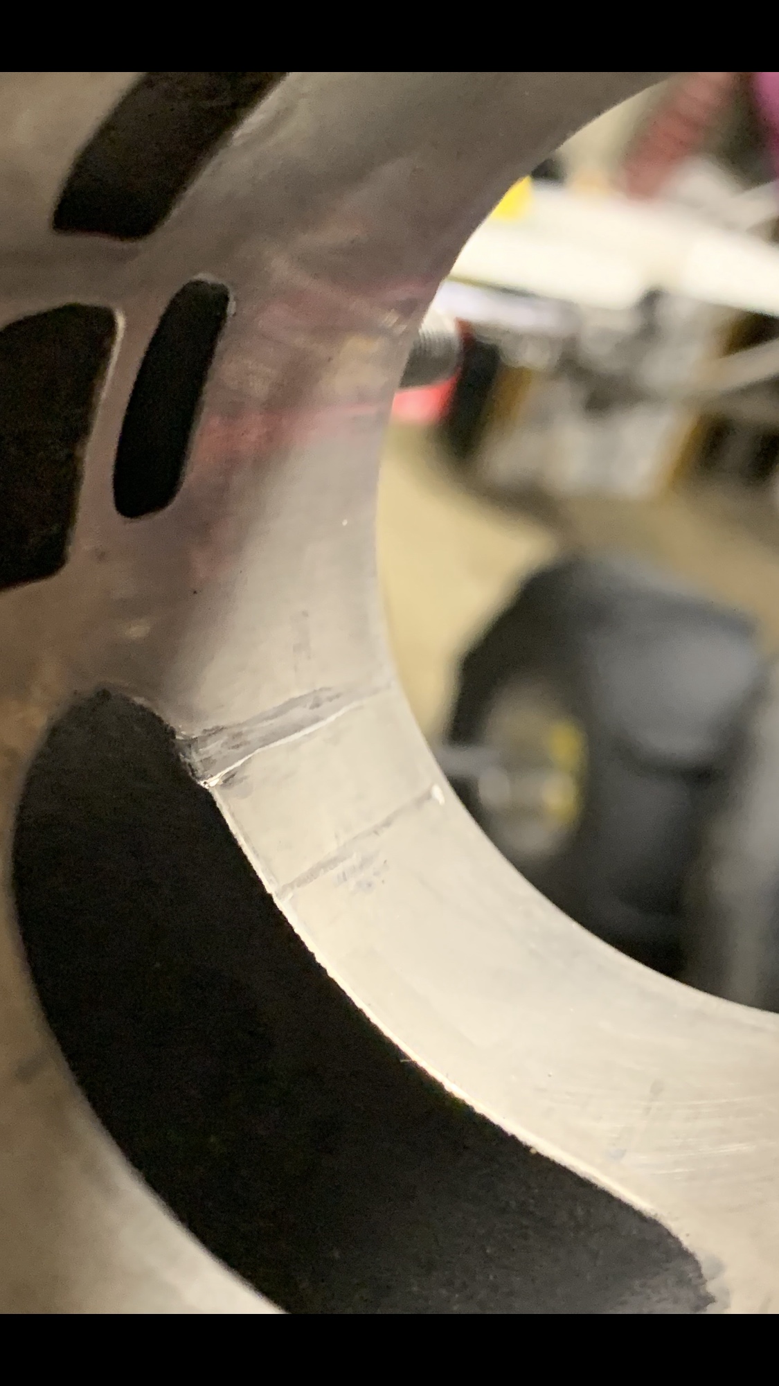

  3. You think the pin came out and the ring turned then caught the edges of port. Sent from my iPhone using Tapatalk
  4. I can see one of the pins but the other one the ring looks like it broke at the pin not sure if the pin is still there.

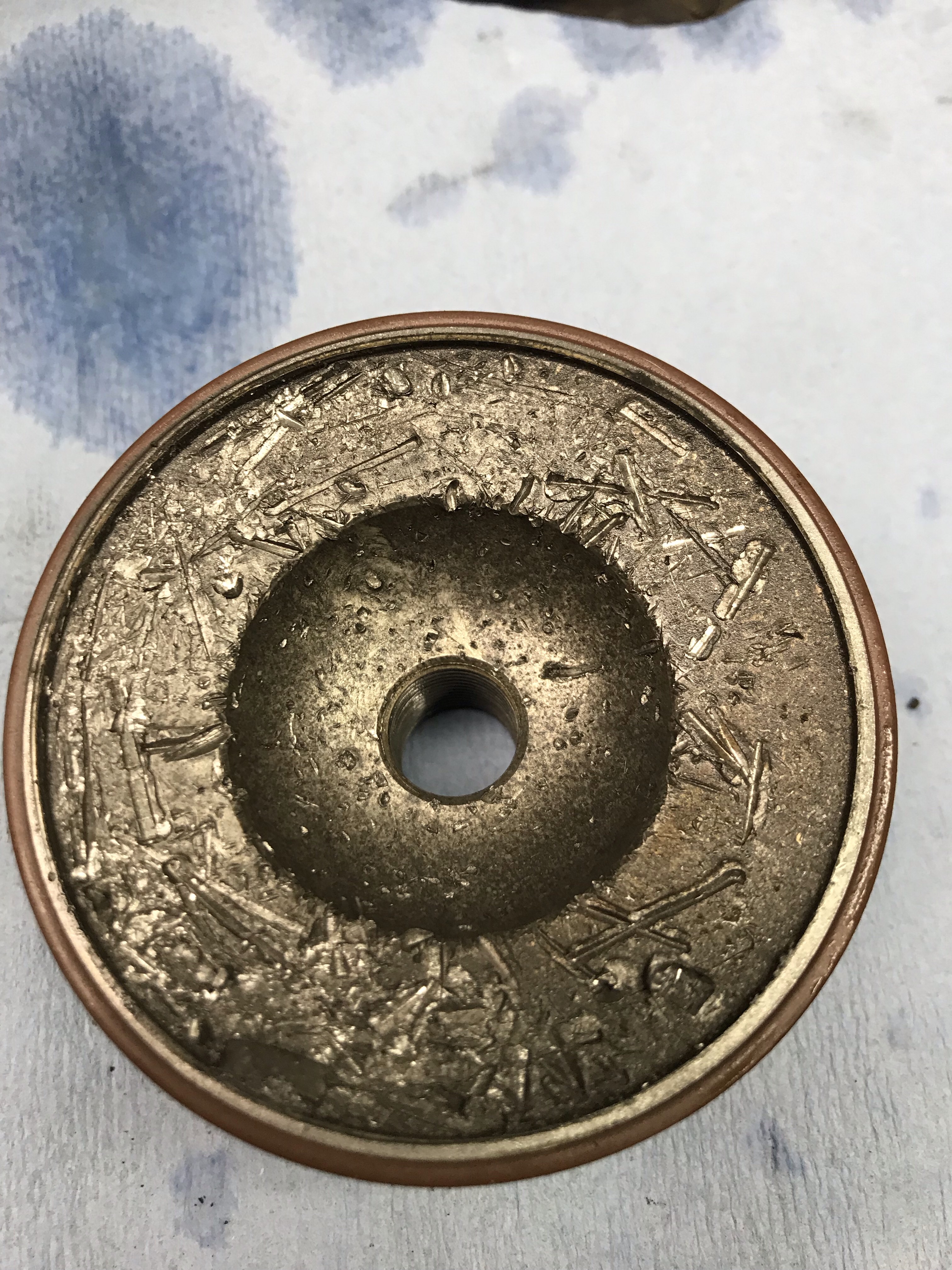

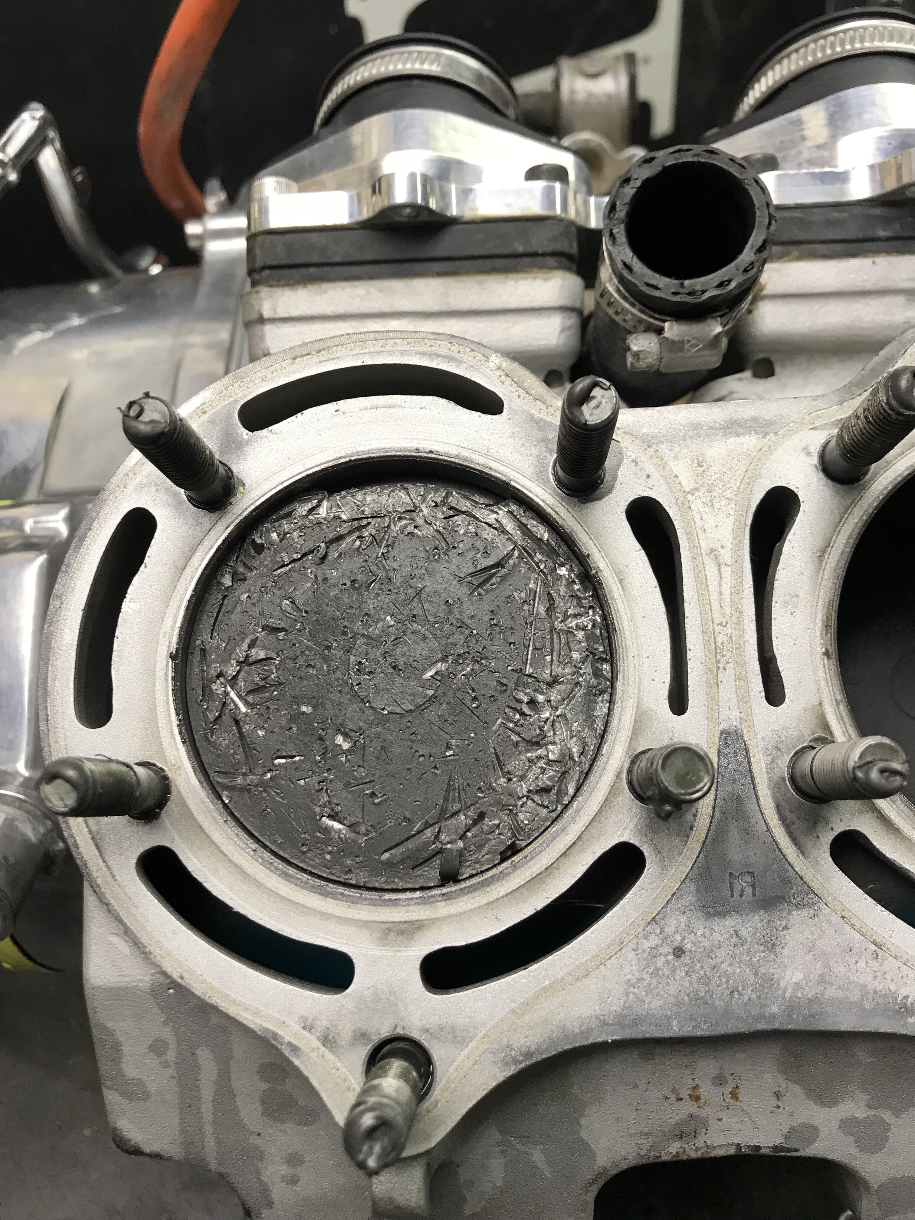

  10. Ring bent and broke on intake side then bounce around the top of piston wrecking the dome parts of the ring in top of piston parts of it went out exhaust . I'll take some pictures when I'm home tomorrow.
