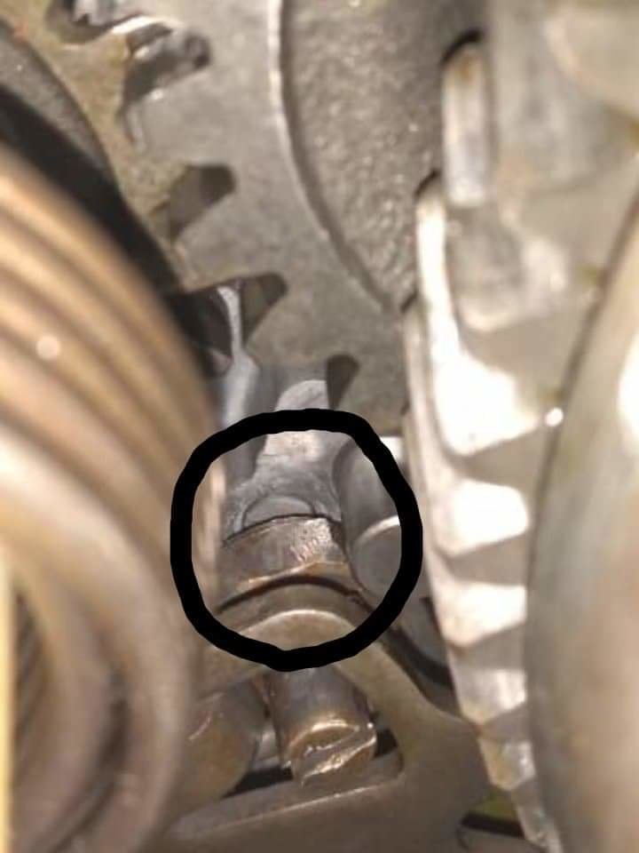

  2. Just rebuilt my banshee, shifter had play in it and for some reason I decided to wait until last to address the situation.. pulled my clutch cover off and saw this.. any way to fix it? Planning on pulling clutches and what not tomorrow. Just looking for some info as what to prepare myself for

  9. Does the crankcase have to come apart to replace the shaft? I'm recently jumping back into owning a banshee after a 12 year break so it's been a while.. thanks for any info

  14. I have tons of play in my shifter. Where should I start as far as troubleshooting ? thanks
