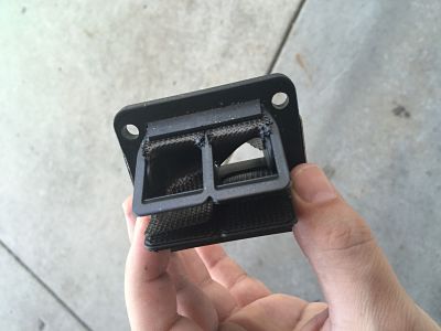

  2. no they are not melted. they looked like there kind of ripped because of being forced the opposite direction.

  4. I recently rebuilt the top end of my banshee. Worked great and then we moved more in the country were i could ride it more. I was coming back and i lost some power but then it would be fine then it died and never started again. So I'm taking it back apart thinking had to be the top end again. I took off the reeds and the one on the left cylinder is completely blown back. Im still new to most of the repairs on these atvs. would this cause the bike not to start? I didn't want to mess with the top end again if i didn't have to especially since it hasn't been that many hours on it. any help will be appreciated. Thanks
