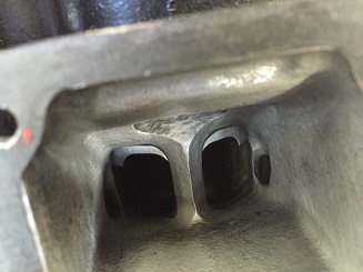

  3. Doesn't that restrict the air/gas flowing thru? I'm thinking its the porting that is off . It's been running bad ever since the guy ported the cylinders. Some guy from my work who said he worked on banshees did it. it looked like he modified the holes in the old Pistons to fit the porting as well .
  4. As I was was moving the piston up and down I noticed the porting on the intake side is bigger then the holes in the Pistons. Are they supposed to line up ?

  8. It only takes a min or less for the power to come back. I've checked the carb bowls and they are full with gas, even messed with the floats so it would use more gas.We ride in glamis, CA. We went from stock main jets 200 to set us back at zero then 280,300,310,330,340. 300-310 ran perfect with pilot jet at 30, but got the same top speed results. I thought maybe it might be the CDI box but it looks to be in good shape. Ive also thought about changing the petcock to the dual one so both carbs have their own direct hose but they are full with gas when i checked the bowls. maybe bigger reeds? I have stock ones . here's a pic of some of the porting
  9. Coils are brand new from Yamaha dealer, stator from racetech electric, I chrcked the gas cap but haven't ckeaned the petcock. I was thinking it might be the porting. When I took it to the local machine shop he said it had more of a drag porting rather then "dune" porting but he said it would run shitty the whole time if that was the case: ill try and get a pic of the porting when I get home
