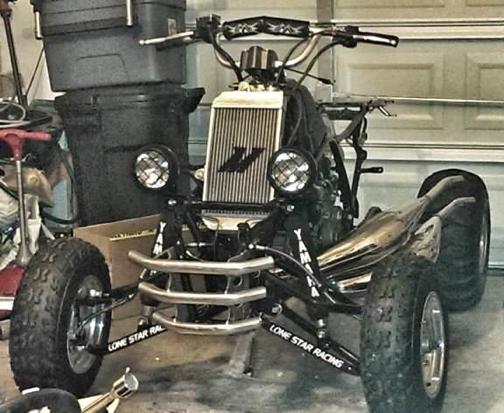

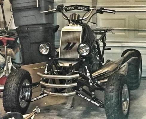

  2. UPDATE I installed the LSR A-arms and put the pipes back on. All new break lines, bearings, and seals. Stripped any parts that had bullshit paint on them, and either powder coated them or used industrial farm equipment paint. Every single bolt has been replaced with polished ones.
  3. I plan on keeping these pipe on for the time being. Like I said, the bike runs strong, it really pulls. If it ever becomes an issue riding the local trails, I might think about selling them. The only problem is, they are so damn loud. When I first got it home, I took it down the street one time and I felt like the whole neighborhood came outside to see what the hell was going on...lol
  4. I got some LSR +2 +1 A-arms on the way too. I got a really good deal on them so I decided to pick them up. I'll post picks when I get them on.

  7. Anybody know what type of pipes these might be?
