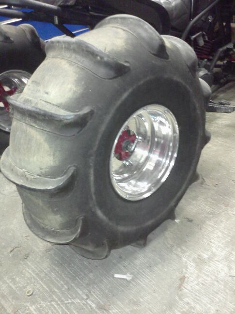

Looking to swap some drag parts. If trades do not equal in value, im willing to give or accept money to make it even. Ide like to trade my 25" taller haulers for a set of 22" 12, 13, or 14 paddles (prefer extremes). Also want to trade my CPI drag pipes for a set of same side (left) pipes. (prefer SB shearers) Also want to trade my Alky 35PWK's (bored to 36mm with power jets) for a set of 38 alky lectrons. Lke i said i know the carbs, pipes, and tires may not be of equal value but ide be willing to add or accept $$$ to make it even. Ill get better pics of the tires, and pics of the carbs, and pipes tomorrow.
