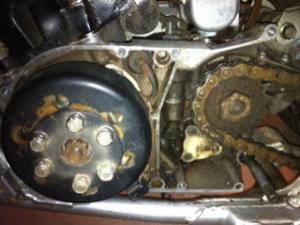

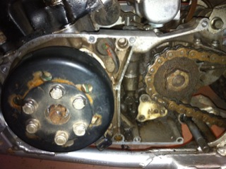

  1. I wish I could say you were wrong...but you were right! Still leaking and its coming from the shift shaft seal- (there was water from a recent wash which was sitting in the stator cover when I removed this- this is why assumed this). How do I replace the shift shaft seal? Anyone?
  2. ok so followed directions- pic attached- found water was laying behind stator cover from recent wash and mixing with the dirt and grime from history of lubrication....so no leak the previous owner put a bead of silicone around stator cover prior to installing..is this needed? Is there supposed to be a gasket?

  6. So ive been riding my recent investment and kicking the shit out of her...but bad weather here in NY today ....so this weekend my shee has been sitting in my garage- i noticed a light oil spot forming on the ground under the stator side of the engine right under the front sproket/shifter and left bike peg...nothing leaking directly underneath the engine....when i looked closer i found its forming between the stator/sproket cover and engine block ..... can i take this cover off to see where the oil is coming from? Do i need to drain any fluids to do this? is there a gasket on this side of the engine? Please excuse me if i dont get any engine terminology correct (engine rookie) but its my best way of explaining this situation.... Thanks in advance
