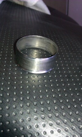

  2. I had to remove the inside bushing that the stock chain slider rides on. So I had to drop the swing arm. After that was removed the Mooose one went on like a champ. Here is the little bastard

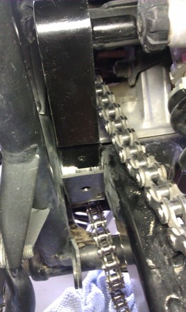

  4. Isn't the purpose of a split slider to ease in the installation so the swing arm does not have to be dropped? Yes the old one was removed. This pic is from the back end of it, you can see the gap that is there.
  5. I wish there was an eighth inch gap. I have like a half an inch. It is so far off the screw will not go into the hole and it will not squeeze together by hand.
  6. I picked up a Moose Racing split chain slider for a stock swing arm. The problem I have is it will not close up after it gets wrapped around the swing arm. Like the hole is to small. Anybody else run into this problem?
