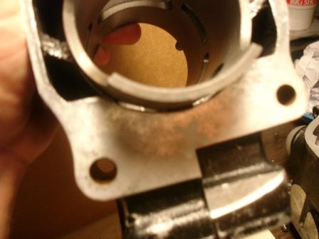

had a cylinder re-sleeved....is this bad? (picture)

yeah i know...they didnt trim enough off the sleeve for the ports. i called them back today and they want me to ship the cylinder back (i recently moved from there) and they will epoxy (im guessing JB weld) the gap at the bottom of the cylinder. before i mail it back, i am going to take it to a local shop and see what they say. i am also going to look up used cylinders on ebay and see what they cost. and then i think i will just have the machine shop buy me a used one off ebay and i will send them the one that they screwed up and they can have a nice new paper weight. this is so rediculous...4 weeks later and the bike still isnt back together yet...shoulda just bought another running bike for that price! -

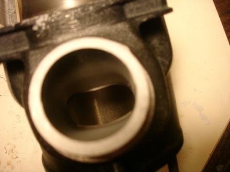

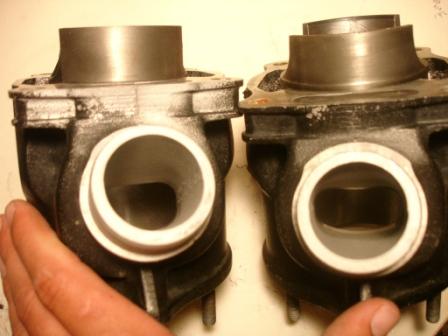

here are the two together...stock on left side, re-sleeved one on right side. notice how in all the pics you can see the sleeve in the ports...they didnt trim it enough??? -

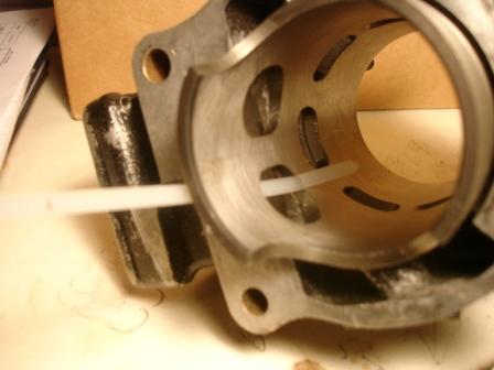

there is a gap between the sleeve and jug... -

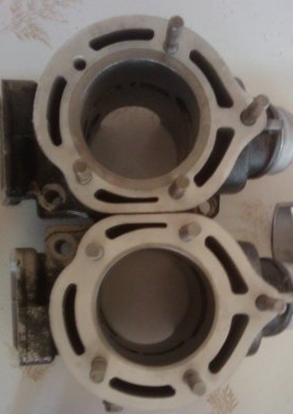

jbooker82, my cylinder looks identical to your pics. except for the last pic. when looking at the bottom of mine, there is a gap between the cylinder and the sleeve. if looking at your pic, my gap would be on the left and on the right side of the pic (intake and exhaust side of cylinder). im not sure if that is ok to have or not. i know the sleve is tapered (top is thicker than bottom). but it sounds like from everyone's opinion i should just run the cylinder and i shouldnt have heating problems. -

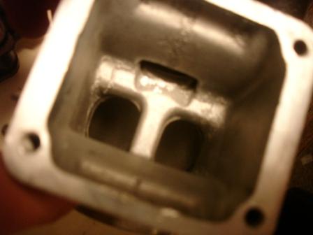

new sleeve on top, stock on bottom does this look correct or does something look wrong? dont mind the missing stud. i took that out to show the space between the stud and the sleeve
