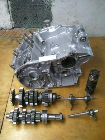

  1. Bump for a good deal guys. The cases are in perfect condition and were walnut blasted and the powdered a bare aluminum color so they look stock.
  2. The cases have no damage.
  3. Fresh powdered cases & complete transmission with brand new shift drum. $200 plus the shipping
