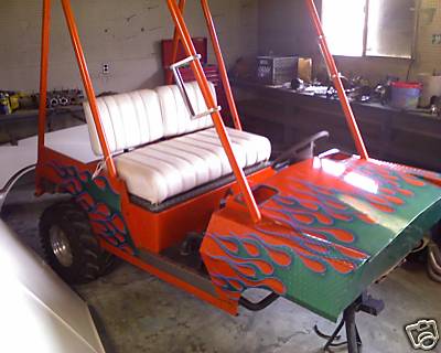

  2. I am building a custom off-road golf cart that is using Banshee A-arm front suspension. I purchased all of the parts that I need on Ebay, but I don't have a frame to get dimensions from for building my mounting points. I was hoping someone has the dimensions or could measure their frame for me. I'm looking for the following dimensions: -Upper A-arm mount width from left side to right side (front tab, bolt hole to bolt hole) -Upper A-arm mount width from left side to right side(rear tab, bolt hole to bolt hole) -Lower A-arm mount width from left side to right side(front tabs, bolt hole to bolt hole) -Lower A-arm mount width from left side to right side(rear tabs, bolt hole to bolt hole) -Height between upper and lower A-arm mounts (bolt hole to bolt hole) -Stagger distance that lower A-arm is behind Upper A-arm I would really appreciate it if someone can help me out with this. Thanks, Nathan
