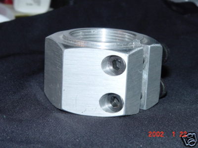

Anybody got an aftermarket front bumper for a banshee they want to get rid of? I have a brand new anti-fade axle locknut for a banshee that I don't need and I do need a bumper. The nut is brand new never used. I am not sure what brand it is, but it's the one shaped like an actual nut.
