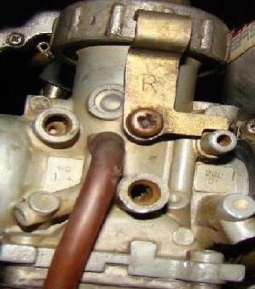

  1. how can i do that, my friend? or i have to take it to a specialist?
  2. here is the video look closeli the first time i put the choke.. thanks VIDEO
  3. I tried all :happy: check the reeds, and all :biggrin: but.. Nothing worken :ermm: So i recorded a video of the shee if it can help i am uploading it i will put it when done.. I need Help! :geek:
  4. Well thank you a lot, tomorrow i will try to adjust everything, and i will check the reed valve and the needle(position) i will bring you news, Tank ou all!
  5. ok, so that little screw in each carb is the air screw, or the fuelscrew? i adjusted it 2 out like the yamaha's mainteanance manual said but my shee has pipes, ignition and a little things
  6. if with T.O.R.S you mean to the big aluminum thing that has the idle screws it has it, but the electric thing it was taken by the dealer.
  7. Well, I tried searching the airscrews.. but where the heck are those. the hose is fitted and perfect, the boost bottle too.. so what else i can try
  8. well, i haven't check the reeds but it was everything fine then the mechanic just changed th epistons and nothing else he also told me that he adjusted the carb for that altitude( around 1000mts) but i have already adjusted the screws, synched and everything Sorry For My Bad englis:D:D
  9. first of all, thanks, well there are no leaks, today i synced and adjusted the carburetors and cleaned the sparks plugs and checked everything, i was wonderin if the needle can be the reason?
  10. I was driving fine my shee untill i blew up m piston:D so i took it too repair, and now i realize that the banshee is running in one cylinder(if i put thw choke in idle both works) i have no clue of what can it be, the carbs are cleaned, the gas is fresh, the lines are fine, there are no leaks. and spark is good. what can it be?
  11. I think My carbs are missing screws or something.. are they?
