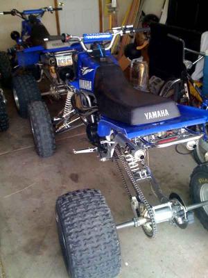

  9. Hey thanks for the ideas, these are all relativeley new to me cause im been a four stroke guy my whole life so if you could share alittle more info about each mod that would be great. the v force reeds i looked them up looks like they go for about $200, it looks like the bolt in between the carbs and the intake valve? I could be wrong. as for porting, how much does this cost? I assume i must have a shop do this? the FAST head, how much is that? also i looked up the timing thing and it looks like there are several options, what is the best route to take. Thanks alot for the info guys, also i would like to stay on 91 octane and it would be nice if i could still keep it starting first kick, so do any of these mods jepeordize taht? thanks alot for your help here is a pic: the one in the back ground is my roomates, its all stock except reeds
  10. Ok, so Ive always been a four stroke guy, just traded for a sick banshee. Took it out today and smoked everyone i raced, untill a 250r pulled up with a 330 sticker on the tank and he roasted me. I was just wondering what you guys recommend for quick easy hp gains for easy relatively low cost mods. heres what ive got so far 64.5mm Wiseco pistons Toomey T5 pipes +4 swingarm K&N filters ( with bigger jets) what else can i do to this machine to get it going faster?? All suggestions are welcome. g thanks alot
