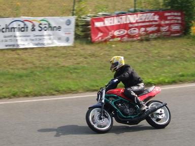

  6. Hi, they work on my rat-track-bike. Here it is :
