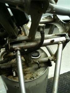

  7. Well I am afraid I will mushroom the end of the bolt if I whack it hard enough to move it that way, as I have already deformed it slightly with hammer. A air chisel might work, where did you apply the chisel? Under the head of the bolt?

  10. Sorry here is a pic of the arm.
