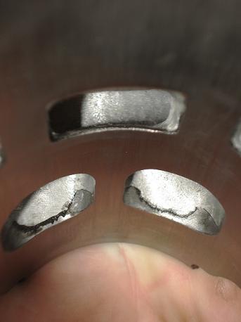

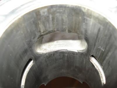

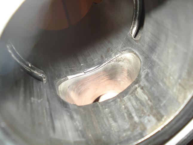

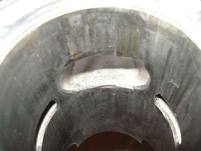

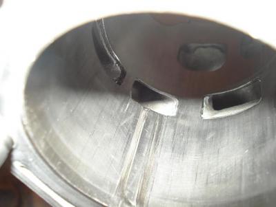

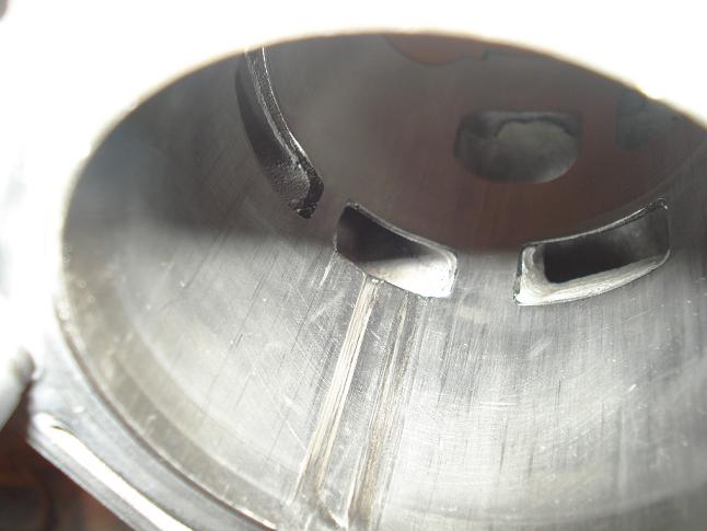

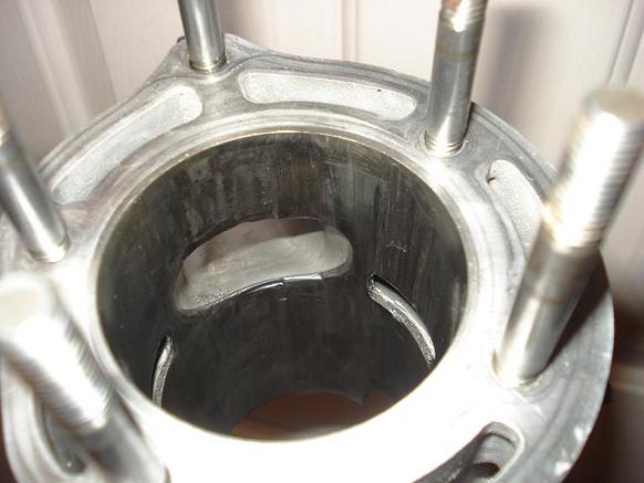

im not going to handle it that way but thanks for the advice. and it was sams cycle supply that did the work. and sam said his guy has been doing machine work for years and years and he has never seen him mess up. i went and picked up the cylinder so i can take pictures to show you guys and thee is no way that they could have fixed up the ports there are chunks out of them i will take pics and post them in a little bit wait till you see the pics..... they said its so bad that the have to bore it 1mm and a half and they are not even sure if that will fix it because it is so bad -

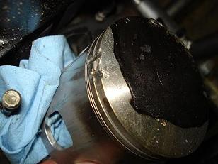

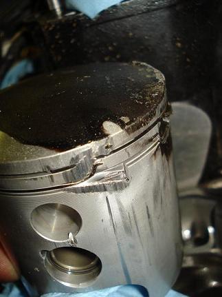

i took the cylinder back with the piston to the owner he said he is going to have to call me when his machine guy gets in... so he finally called he said his guy did a 100% job on my cylinders and the port work. he said it was all my fault. his first excuse was that i put the piston on backwards. then he tried to say when we put the cylinder on we twisted it and it moved the piston clips and thats what screwed everything up. well i got home i checked out my other cylinder and piston that piston is on the same way asa the other so its not a backwards piston. and my buddy that helped with the motor said he did not twist the cylinder and now the guy that did the machine work does not want to pay for anything -

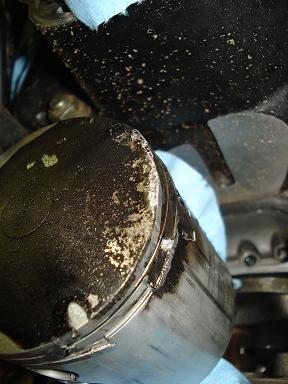

i went back to the shop today and the guys that were there said the cylinders are bad!!!!!! and the piston clip hit the exhaust port there is a big chunk out of the top they were speechless. i told them that they didnt chamferd them and they had no idea what i was talking about. they told me to come back tomorrow when the owner is there to see what they can do -

i didnt check the ring end gap or the bottom end i am taking the cylinders back to the guy that did the machine work because there is a big chunk out of one of the transfer ports. -

im starting to think your right on the porting that the ring hit because there is a chunk out of one of the ports and the back of the ring is missing -

i just rebilt my motor had it all ported polished did coolhead bigger pistons and everything. it ran good during the brake in took it to the dunes for the weekend and came back did a compression test it had 150lbs in the left and 30lbs in the right tore the motor down pistons were black and one was missing half of the clip an there was chunks outta the top of the piston and the cylinder is damaged. i did gear saver oil in the motor and mix castor 927 in the gas with a 40:1 ratio. what happened? what should i do different next time?
